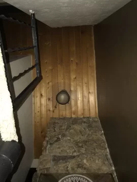

I attached the picture of the stove room. The spiral staircase leads right up to the bedrooms, our main bedroom is right above the stove room

Is there a high peaked ceiling over the upstairs area, like in an a-frame? or a loft above? If so I suspect that is where the heat is going. Poor roof insulation would make the problem worse. You could check this out by placing a thermometer up near the peak at the top of the stairway.
seems to me to be a pretty small stove to heat anything beyond the immediate room.
The house is under 1000 sq ft. With a normal ceiling height and the insert at the foot of the stairs, the upstairs hallway should be quite warm. I'm guessing that the heat is stratifying above the bedroom ceiling in the loft area. If there is poor roof insulation then they could be heating outdoors more than the bedroom.

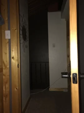

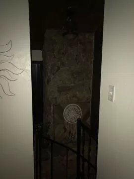

Having heat issues for sure. Yes there’s a tall ceiling, also a loft up there as well

can you be more specific with temperatures? is toasty 80 and freezing 40? An oscillating fan on low, on the opposite side of the room from the stove may help circulate the air as well, allowing it to go up the stairs?
I have the same problem in my staircase that there is a zone where the war air just cannot rise any higher and you get almost like a lid that you feel when you go up the stairs. I haven´t tried it myself but if you have almost no heat at the top of that staircase you could try to create a "chimney" effect by adding a radiator on one side of the stairs just to get that side warmer so that the warm air can rise on that side and the cold air should then fall down on the other side in theory at least. I have tried with fans from the stove and also a cealing fan at the top of the stairs but it didn´t really do that much difference so my last resort is to get the chimney effect going in the staircase.
