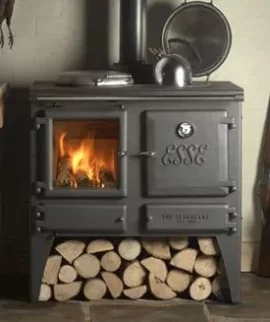

Years ago (and even to this day) I wondered why no manufacturer offered a wood cook stove with a firebox that could hold a fire for more than a couple of hours. I made some (primitive) drawings for such a stove at one point but never got around to acquiring the skills to build it.
Attached is a photo of the Esse cook stove (made in the UK). It's about as close to what I might have wanted to build as I've found. Very pricey, though.
If you can put me up for a few months at the Biltmore, I'll come down to Asheville and help you build your own.
Good Luck.
