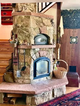

I built this one for a friend in 2008. Smoke goes up through the bake oven, hits the ceiling, goes down the sides, then out the back and up the chimney. Very nice even heat, but a little slow response time for my taste. I don’t think it fits her lifestyle, you need to have a fire every day for it to be effective. The evenness is diminished if it goes cold
