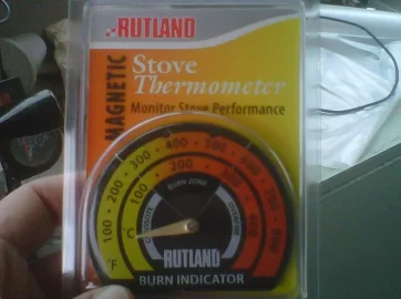

Sorry I didn't realize this topic would be a bone of contention!! Is there a thermometer that you guys lean towards I'm heading to home depot or lowes now. Thanks
Is this a good one to use and it says not for double wall stove pipe. So can I just lay it ontop of the stove ??

I like the condars better but that should work, and you should be able to put on the stove top, you should have one for the stack also.

The only real concern I have w/ the rutland is that the "burn zone" is a bit low in the temp scale. The rutlands use an average of what temps should be seen as a max for stove top and stove pipe. Condar makes separate thermometers for each application. 650 should be a reasonable "red line" for your stove top.

Rutland or Condar will work. On the Isle Royale, most people put the thermometer in the middle or slightly to the left of middle on the griddle top.
Agree with Pen on upper temps. Try to keep it under 700, and you should be fine. I find it runs best at 550 and above. With a smaller fire,
use less wood and start cutting the air at 550. Leave enough air coming in to keep the temps up there. As the wood burns up, temps will
start coasting down, but then most of the volatile bad stuff has burned off
It will be just fine. You don't need exact numbers. You just need a good estimate. All stove top thermometers vary. If it reads 560 You know you are burning at around 550. If it reads 585-590 you know you are near 600. This is more than good enough to know what's going on.
On the ones I have they are 100 to 150 degrees off in the upper temp. ranges when compard to a IR tester.

Found a similar thing, my condar reads spot on until about 725 and then it just about freezes up.

The four I have vary in a 150 degree range with the two in the middle being north or south of the IR gun buy 10-30 degrees. The other two are... inconsistent to say the least.

I'm pretty sure one of the two that I have that are inconsistent is the one that I pegged the needle with a few times on the Vigilant...
We have a couple different stovetop thermometers....I have found the Rutland stovetop one reads about 100 degrees higher than the IR thermometer...the Condar one is pretty much the same as the IR gun....
