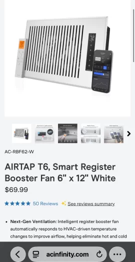

As you can see the 1st and second floors closely mirror each other.
Red on first floor shows where I plan to take down a portion of wall to create a doorway as currently you must walk through dining room to enter the kitchen and new doorway will allow better airflow into kitchen.
Blue on second floor are registers I’m thinking of cutting. Placed as far away from the top of stairs deep into the room to draw heat upstairs and allow olde air to gravity drop back to 1st floor to get gated up and create circulation.
Thinking of using these smart WiFi booster fan registers to help create circulation. Worst case I may have to take apart to switch the wires so the fans run in reverse. I like that I can control them with my phone off property but they come with a remote to use if close by.

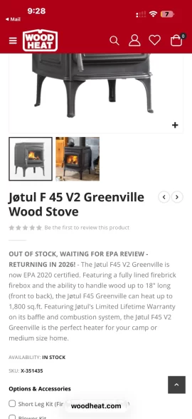

I guess the F45 is being rereleased very soon with many already built just awaiting EPA to stamp them.
So would you say between the Jotul 445, hearthstone shelburne, and the Jotul 45 what would you suggest top to bottom, and any other rear venting stoves you may be thinking of.
The hearthstone’s seem to puff smoke when reloading, some say Jotul quality has gone down in the last few years.
Is staying away from cats so important?
Dealer said the Jotul cats are robust but you can’t bypass them.

So the dealer called me today and said recently they were notified the Jotul F45 was being brought back, that stoves have already been manufactured and awaiting roa emissions testing stamps before shipping out to dealers and if I wanted one I’d be first on the list and to expect a mid November arrival
So it’s a 445, 45 or the shelburne to pick from.
Thoughts?

As I’ve replied to a few other members I was just notified today that Jotul is re releasing the F45 and has already produced some and awaiting epa emissions test stamps and the dealer said their Jotul rep said to expect mid November deliveries.
