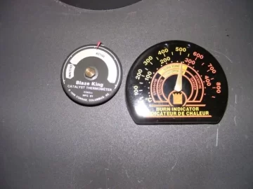

A raging fire doesnt tell you if you stove is up to temp. There are many reasones to know where your stove is at during its burn cycle. Therefore what type of stove/insert is important. For example......VVVVV
