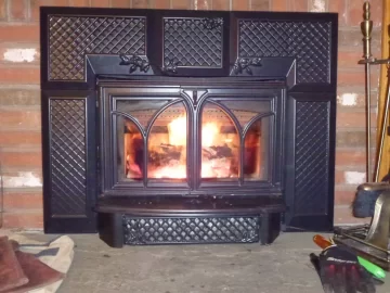

I just replaced mu Jotul 20 insert of 25 years with a lightly used Jotul C450 Tamerax The was just a convection stove no fans cast iron inner stove with a damper and air inlet, I would build a fire, boom ,heat, keep it fired up it wood drive you out of the room. My newer C450 which I hooked up to the connecter kit from the 20 till I can put in the liner, just doesn't put out a lot of heat, glass is 500 550 degrees unless you have the blower going full blast it doesn't do much and I did remove the block off plate on the top surround which helped somewhat. My old stove kept the house warm fro the week of power outage two years ago from the freak late October snow storm. I don't have to much faith in this stove as a back up with out the blowers running. The house is well insulated 2x6 walls 12 inches in the attic. I know I am not burning the best wood being sliver maple but it is what I was burning in the old stove. Can I expect better with the liner?View attachment 119999
As stated previously, there are no secondaries visible despite a very active coal Bed. Even my Quad 4300, which I despise, will get good secondaries. Flames shooting out of the tubes like blow torches and a cloud of flame hovering over the wood.
As others have said, no secondaries firing in that pic

Long due update, I had a liner installed a few weeks back and was able to get a hold of some well seasoned oak, big improvement! Cranks out good heat now with secondaries flaming away. Wife is happy.
