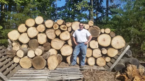

There was another thread asking if 16 rounds season. I know from experience that rounds dont season but never noted what happens to a round just letting it sit.
The thread about the 16 in rounds prompted me to post these observations
The first pic is of some rounds i cut up in the fall of 2017. All rounds were cut to 18in. The trees came from a friend that has a tree service and were cut down live in August of 2017. Lets just say that the MC of the trees was 43%. All the rounds that are in the pic are oak, some red some white.

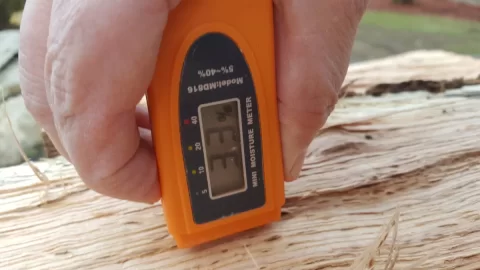

I am now splitting up some of ths wood so I put the moisture meter in some of the rounds and also made some observations
I took some rounds and opened them up and got a few different readings most rounds were average of 33%MC. Some of the larger rounds of aprox 24inches still had alot of water. When the wedge went into the round you could still see water.
The rounds were stored at my shop up off the ground and tarped on the top, in sun and with air circulation. Please don't post that the rounds are not room temperature. I understand that this is not a precise reading but just getting it close enough for the observation and being able to get a general idea.
Bottom line being.. the seasoning process dosent start untill the rounds are split

I think hardwood rounds would just take decades to season depending on the species.
I have rounds that have been sitting for 2-3 years and while they do hold moisture inside when split they are very much more ahead of the game so to my knowledge rounds do season. You have Oak so that holds in the moisture longer, and the Oak rounds I split even though they have been sitting for years still have some aroma to it so they still aren't "seasoned" but they are very much on their way.
Theres a big difference between losing some moisture and seasoning. I think you missing the point of the post. I am answering a question to a post.. do rounds season. The rounds have been cut and stacked now for 18 months and lost approximately 10% moisture. So yes they have lost some moisture. But in the same period of time the wood that was split in 2017 is ready to burn and well under 20%mc. I you take this 1 step ferther, these rounds that were just split will take another(roughly) 18months to fully season. That bringing the total seasoning time to approximately 36 months to season. That is almost doubling the time and clearly not worth doing and also answers another post. This also clearly shows that when giving advice on this board rounds dont season, thay just drop some moisture. I dont think that losing 10% mc in 18 months qualifies as well on its way.
I would be curious to know if you noticed any differences between the red and white regarding moisture.

I had huge maple rounds about the size of the big ones in your pic sit for 3 years, when I split them water gushed out, I was surprised they still had that much moisture.

I think your right on this.. some of the larger rounds like over 24 in still had water coming out when the wedge went in.. while the 16 to 18 in stuff didn't have water coming out..

If you really want to measure the moisture content loss in the round - use a weight scale, not numbers pulled out of thin air.

Clearly your not reading verry well.. there were no numbers pulled out of thin air.. in 1.5 years the rounds only dropped 10%mc. I even posted a picture of the MM in the freshly opened round.. guess you missed that one.... BTW weighing rounds of this size really isnt practical.. guess you missed the picks of the rounds also..
