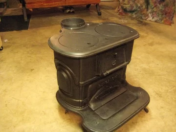

Fired up the stove for a test-burn over the weekend:
  • [Hearth.com] Do you have an Atlanta Stoveworks Box #27?
Thanks for the pics Stegman, looks very familiar! Thanks for the parts schem. also. It looks like you've done a good job taking off all the rust. Mine had wore rust damage because it had sat, without the legs, in a basement that got flooded. These stoves are so fun due to the simplicity and old time feel they bring into a room.
Now to answer your questions:
1. I was going to do the cement and try to make it airtight primarily in order to prevent it from smoking up the cabin. But if that’s not a big concern, I might forego that. From what you’re saying, it sounds like making it airtight is done to improve efficiency. If I don’t do the cement, will it emit smoke like crazy?
I did not take the stove appart in order to cement the seams. I just added some to the seams I thought needed it from the outside and inside the stove. This is not the proper way to cement it. Most of that cement has since fallen off and it did not change the performance of the stove. I never had noticeable smoke pour into the room from the seams. The North to South design of this stove makes it draft very easily out of the collar.
2. I was going to do the stove polish, but after I did the once-over with WD-40 and steel wool. Is that overkill? If I can skip the WD-40 step, I’d be more than happy to.
From what I understand, people used to polish their stoves a couple times per burning season. This was a common practice for people in the hay day of old non air tight cast iron stoves. They used to let their stoves cool off on Sundays and polish it in place. Then open the window nearby to let the smell out when restarting it. The polish supposedly covers up, penetrates and prevents rust. You can even apply the polish without removing minor rust and it'll look like new. So, I guess the answer is, I would just slap one or two coats of polish on it and you're ready for break-in fires. If you have a piece of stove pipe laying around I'd put it on the stove to do the break in fires outside and you can see that no smoke will leak out of the stove during light off. Just get a draft going with a piece of newspaper near the stove flue.

We're actually in Sterling. Just moved there over the summer after spending six years in Grafton and five before that in Worcester. My wife and I grew up in Westboro.
Thanks for the info. During my test burn over the weekend I didn't notice too much smoke coming from the seams - maybe a little out from under the top plate. It was hard to tell because I didn't have any stove pipe around, so the wind may have been causing some optical illusions. It does look like there was a bit of soot left over on the top near the edge of the top plate, so I think I may try to hit that area with some cement.
What was really interesting to me was how the fire would die down when I closed the front door. Despite it not being an airtight stove, closing the door seemed to choke off the airflow quite a bit. So what I did was remove that middle plate in front that covers what I guess must be some sort of ash-removal compartment. That gives about an inch of clearance under the door. Once I did that I was able to close the door and keep it raging pretty hot.
This bad boy is ticketed for a small cabin we have up in Vermont that is currently in the process of being spruced up. Based on recent history, it will probably be a couple of years before we're actually able to install and use it. I think in the short-term I'm going to polish it up and slap some cement on it and have a few more outdoor burns.
I'll post some more pics when it's fully restored to showroom condition.

Just wanted to add my find and experience with these to the thread. I found both of these stoves by accident one day while I was out and about. they were sitting in some guys yard full of cigarettes butts and were in such poor shape he gave them to me for $150 for the pair.
Should have took a before shot but didnt think to do it at the time. I broke both of them completly down and hit them with a wire wheel on an angle grinder to clean the rust off of them and polished them up with WD40 and they look awesome I can not wait to fire them up. The only problem I had was them 13.5" Main Body Rods all snapped on bothe stoves so I had to order more. I had a terrible time finding new ones. I finnally tracked them down here. http://www.usstove.com/index.php?route=product/product&path=173_178&product_id=1553
They are not cheap. On the bungalow I found they were actually too short so I had to fabricate my own from .25" steel from lowes. Had to heat it up with a torch and shape the flat end and threaded the opposite end with a die.
I fiiled the seems with Mega Black High Temp Gasket Sealant http://www.itwconsumer.com/userfiles/files/techdata-sheet/VC Tech Data/99839 TDS.pdf
Hope that stuff works heh heh.
They are not Atlanta Brand But Birmingham Stove and Range Company - these Atlanta stoves seem to be complety identical. This Forum was the closest I got to getting any info on them.
