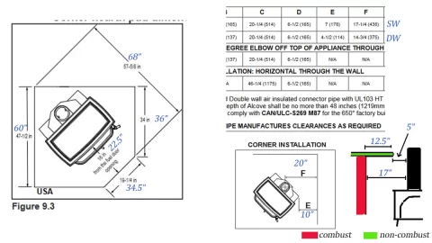

Ok, as promised, here are all our final clearances. I also included a little illustration in the bottom right corner showing the clearance to the bar top/mantel; as previously mentioned, it is a solid granite overhang. There is no wood supporting it, only metal brackets that are on either side and not near the pipe. The clearance from the stove pipe outer wall/edge to the granite is only 5", but as mentioned, it's non-combustible. With a hand test yesterday, it's warm but not burning hot near the pipe (I can keep my hand on it when the stove was in the 300-360 range); about 10" away it cools down considerably, and feels no different than the rest of the countertops on the other side of the slab (the edge farthest from the pipe). That said, only non-combustibles are "allowed" on the countertop during operation of the woodstove, just in case. Also, as you can see in the chart, there is still plenty of clearance from the stove to the combustible portion of the wall supporting the countertop.
I also don't have this written down on the diagram (although I wrote it on the previous page) but this stove calls for a hearth with ember protection. Ours has that plus an R-value of 1.48.
And that's it for now! The next update will be the touch-up job on the paint.

Ignore the .5” difference on the countertop overhang; there was a piece of trim that wasn’t accounted for when I measured from the wall to the edge of the overhang, it should be a half inch shorter, because, well, math.
That should work out well. You will be glad to have generous clearances when the stove is pushed for heat at 650º. Where are you reading the temperature? Any luck with the bees nest removal?
Enjoy your Christmas! And congratulations on the nice install.
