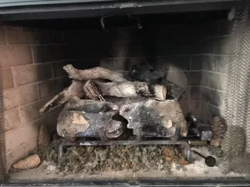

I live in North Jersey and finding it difficult to get accurate install information. My house is 27 years old and has a Marco wood fireplace that was converted to gas logs by the previous/original owner. The gas control valve is leaking so I would rather replace it with a gas inset so I can utilize the ability to heat part of my house that we spend the majority of time. The current fireplace has a viewing area of 38.75"W X 18.25"H so the majority of fireplaces would be a significant reduction. Unfortunately, the height is under 19 3/4" so I would need to remove the bottom louver to gain an additional 4-6". I am interested in the Mendota FV44i and Lopistore 616 to get the maximize amount of viewing area. Both of these units seem to be in the $6500-$7500 range w/o gas/electrical costs.
I contacted a few dealers and have gotten a few conflicting things:
1) Everything I have read was the gas insert would slide into the existing box and input/output lines would run to the cap. A local HVAC told me that they would need to open up the wall from the hearth to the cap to remove the box/vent and then reframe the wall for a new fireplace and install box/vent pipe. That doesn't sound right to me.
2) To support the larger inserts, the lower louver would need to be removed so the new insert would sit flush with the floor allowing for additional height. The dealer made it clear that I could not go back to a wood burning fireplace and the town would be notified. They mentioned they have only done this a handful of times. I don't see an issue -- I would never use wood and I can't imagine this being an issue with the next owner. They can re-install a new box if they wanted to. Is anyone concerned?

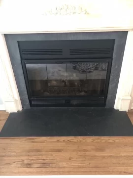

3) Given inserts use the existing fireplaces, they will have to be installed with existing surround/tile/etc. For mine, I would need a panel that would cover all of the existing black Marco box that borders to a gray slate stone. How would any of the existing surrounds work? After the face/profile is installed, the surround would need to be installed and it appears that nearly everyone would need a custom cut to ensure it seamlessly fits into the existing fireplace.
Marco
Model 792864B
Door kit 793412
Grate 498859
Blower kit 793623
Serial 90915
Existing Box
24.75" back width
17.5" depth flush to door + 1.5" bricks removed
36" width flush to door
19.75" height
Overall: 41"W x 36.75"H
Viewing Area: 38.75"W X 18.25"H
Log Set: 21.5"L X 13"D
It ISN'T right for an insert install...
If you were replacing the wood burner with a gas FIREPLACE,
your HVAC guy would be correct, an entire new venting configuration would be required
Gas insert venting utilizes the existing flu, if the liners will fit.
You will need a custom surround. The company I work for, makes them ALL the time.

Marco has been out of business for over 20 to 25 years. Both lopistove dealers contradict each other. One says DVL 34 can be used because it has a bottom Louver for the controls but the Mendota and Lopi 616 can’t be placed on the bottom due to heat transfer. The other dealer said no problem and put it on fire bricks.
I’ll call dealers directly and hopefully get a clear answer
