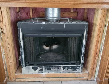

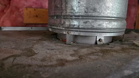

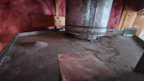

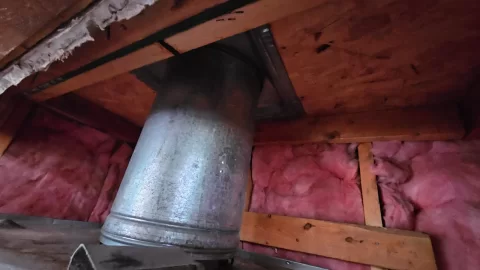

Hello!
I am removing my gas decoration and installing the pellet stove. I choose HP22.
Anyway, I am trying to remove the gas box, and it only holds by the chimney pipe. This is where I stuck. I need help to understand what to do and what to keep. Posting the pictures. Help me understand what this double wall pipe is. Adapter? Safe to remove? How? What would you do?
Thank you!

So, back to removing the gas box. Cannot get the chimney/pipe out. Is there a way to disassemble it without cutting?
What is this even? B vent?
Thank you!

It it air cooled low temp chimney for a prefab wood burning fireplace. The sections are snap locked together with tabs inside and out. Start from the top and pry the tabs apart with a flat screwdriver outside first then inside. Work your way down.
