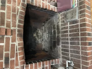

We recently bought a house with a masonry fireplace+chimney in rough shape (image attached of fireplace - the chimney is similarly gruesome). We had a chimney inspector take a look. They recommended a large amount of restoration work. My overarching question is: how much of this work is necessary if my intent is to install an insert, not use it as a traditional fireplace?

No most of that work is not nessecary for the safe installation of an insert

if it’s structurally sound and water tight an insert with an insulated liner is a good choice. I like the arch get a trim able or custom surround or go without.

This looks like a heatform-style fireplace. I see the vents on the fireplace. An insert will be a nice improvement here.

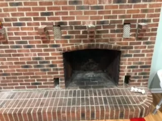

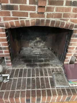

Interesting, didn’t know the term “heat-form”. Should I have the metal firebox torch-cut out (another thing the inspector suggested)? It is very rusty, including the damper. They also said to brick over the vents - good idea?

I wouldn't it's part of the classic look of the fireplace.

There is no reason to remove the heat form completely to install an insert just cut enough to get the new liner through. As far as the vents go yes they can be bricked closed. But I usually just pull the covers stuff them full of rock wool and put the covers back on with a solid plate behind them
