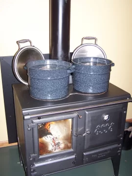

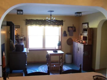

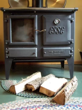

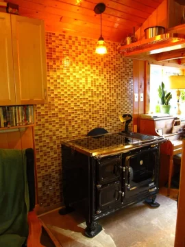

I would take a look at the Esse IronHeart... I'm really happy with my stove.. 700 lbs, you get what you pay for... Great heater, easy to run.. Has nicely designed door latches which make it breeze to adjust the door gasket tightness.. A nice feature to have on any stove.. Holds a fire overnight as well,, always has coals... Can hold a good amount of wood as well.. I'm sure you'd be really happy with an Esse...

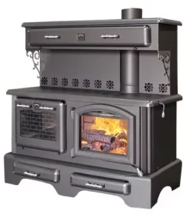

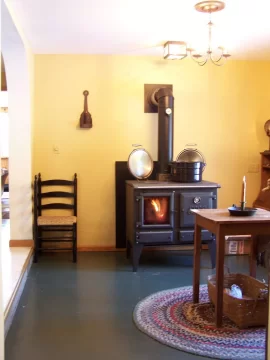

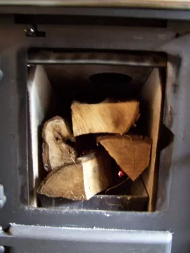

Sarah, thanks for the feedback and I totally understand your concerns. I will look into the firescreen but I'm pretty sure it's like the screen on the Ironheart that Charlie told you about. Because when you stand in front of any woodstove with a glass door, the radiant heat coming through the glass makes it too hot to stand in front of. Therefore ESSE has a screen that slides in front of the glass door that defuses the infrared rays coming through the glass and breaks them up so they are not so intense. I don't think that the Cuisiniere is meant to be burned with the door open. http://woodstoves.net/cookstoves/cuisiniere-cookstove.htm What is so unique about the Cuisiniere is that JA Roby actually took one of their largest woodstoves the Tison which I believe has been in production a while now, merged it with a cookstove body, essentially converting a clean burning woodstove which has been tested to CAN/CSA STD B415.1-10 and should pass US EPA Certs. This is an idea that I have been kicking around now for some years as I am considering producing our own line of EPA/UL Certified Cookstoves. A Canadian customer turned me on to this stove who is a bit of a tinkerer like myself. When I first saw it on paper I was pretty stoked! http://woodstoves.net/documents/JA Roby/cuisiniere-tison-manual.pdf thinking to myself, this will save me sometime and effort to provide my Washington Customers with a Cookstove that will meet their standards. My understanding it that the Cuisiniere has been available in Quebec for a couple of years, but finding any reviews in English is like finding Hens Teeth. At 1.349 Grams Particulate Per Hour Emissions, I would finally have a Cookstove that would meet any regulations coming down the pike, anywhere. So I partnered with JA Roby and offered to market the stove for them. When I researched the company, they seem to have a pretty good track record at building excellent Hearth products, furnaces and oil stoves, but they are not very well know outside of Quebec, they don't even speak English, but French. Our plan is to burn the Cuisiniere ourselves this winter and fly out to Quebec next Spring to meet the owners. I am sorry I cant say that I have much experience with the stove other than what I have explained. Judging from the size of the firebox and the efficiency ratings, I am expecting at least a 12 hr burn from the stove, using softwoods found here, longer with Hardwood I would suspect. As I have just returned back to the Yaak from my Missoula Base Camp where I dispatch from for emergency wildfire suppression, I have some cookstoves to sell before Annette will let me bring in anymore. I should have my Cuisiniere soon and it will be getting cold enough to where I can install it and burn it allowing me to have first hand experience with the stove.
Before I take on another project I need to get those doors for the Kitchen Queen done so I can You Tube them so folks can see them. We have lots of folks waiting for them. I am not sure what we'll end up charging as I am waiting for Montana Machine to make the face-plates. My buddy Kevin helped me fabricate the doors and test them last winter, he will be building them for us along with the custom heat shields we also offer. Our main problem is it takes a press to stamp out the face-plates that will be Stainless Steel and fit over the top of the actual steel door. There will be glass doors for both the firebox and the oven, just like on the Cuisiniere. I think it will make the Queen look a little less homely, I hope. She may not be nearly as nice looking as the Flameview, but beauty is only skin deep. Just like best wives don't have to the prettiest on the outside, but what is on the inside is what matters most. She is the heaviest we offer, but man can she cook! The glass doors will lift on and off in a matter of a minute you can swap out the doors.
The Queen comes with an air cooled door on the firebox, so standing in front of her when she is cookin, is not a problem, it will be when you add the glass door so we'll probably have to come up with a sliding screen like on the Ironheart that you can slide over in front of the oven when you load her up, and back over in-front of the firebox when she's cookin, or you can simply lift off one door and swap it with another.

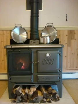

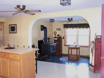

Sarah,

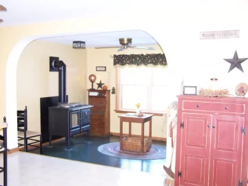

I love my Esse , but certainly like the looks of the Cuisiniere...I think I would have no problem liking that.. Oh and by the way, once you have a cookstove, you'll have it going all winter.. You'll love it watching your food cook and it also heating your home at the same time. It's a great independent feeling having both of those things going on at the same time. The really nice thing I found out about always having the stove going, you want to warm something up on the top or the oven, you have instant heat... You'll use the stove more then you think..I'd never be without one and everyone loves the stove when they walk into our farmhouse.. It get's lots of likes :) Some pics of the area open to our kitchen that made the perfect location.
