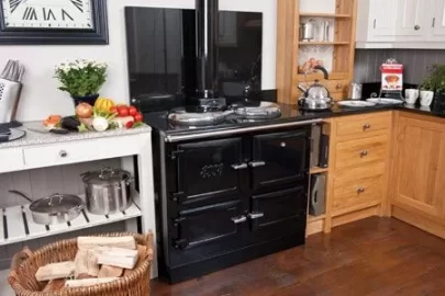

Steve, It's ashamed that the AGA Wood Cookstove is no longer available through Heartland, it is an excellent cookstove. I believe the AGA is only available in gas or electric now. The Artisan is available as a wood cooker. I mean you no disrespect but I was under the impression it was not a very good heater as the stove is insulated to keep the kitchen from overheating when in use. I am curious about how that works at heating 1100 sq ft. ? I understand that opening the Hob Lids will let some of the heat out, but its radiant and pretty much localized to the area the stoves in, unless it is connected to a central heating system with a boiler in the firebox pulling the heat out and moving it elsewhere, but I did not know that the Heartland AGA was offered that way. I don't know that I would want to try to heat with an AGA anywhere it gets very cold, I understand that you have a second stove for when it gets cold but saying "As for the original question by the OP, our stove will heat our entire home, 1100 sq. ft" would lead most folks to believe that the AGA could be used as a heating stove. As I have shown in the pictures below these wood cookstoves can be installed like any gas or electric kitchen range next to combustible cabinetry specifically because they are so well insulated against transferring heat.
We are now offering the ESSE 990 which is comparable to the AGA in many ways, so those looking for an excellent wood cooking stove that wont drive them out of the kitchen will have another choice. http://www.discountstoves.net/Esse-990-Series-p/990.htm The 990 has finally come through testing and will be ready for shipment this winter and we will have them available for our customers. Best of all the ESSE 990 can provide heat and plenty of it through the ESSE Central Heating System that converts the 990 into a central heating system by piping hot water to other areas of the house and dissipating it through radiators. This You Tube shows how that's done.

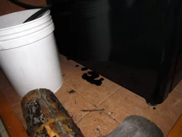

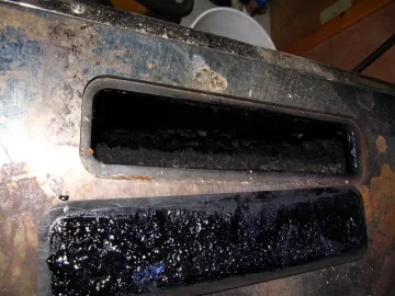

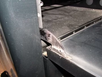

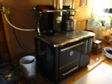

Ok, today my neighbour went out to clean the chimney on the flameview, so I went along, so even though I don't yet have the report back from the owner, I have some observations to share. Mind you, I may have looked at something a bit more closely when I saw something obvious, I did not go to any length to scrutinise it and inspect it as the stove was still rather warm (top was anywhere from 110 to 230+ depending on location) and the oven was reading around 210-220.
Which brings up the one nice thing I noticed. The thermometer on the oven door was reading the same temp as I got with an IR scan of the interior and the centre of a pan that was on the oven shelf. That actually surprised me.
But, woody was sure right about the oven hinge. It was coated in both ash and tar. There is some dripping down the sides of the oven drawer beneath, and some ash accumulation in the drawer and in the things kept in there. But that leads us to (sounds of dinosaurs caught in the la brea tar pits in the background...) the pool of creosote on the floor...
You know, it's actually a good thing if those louvered vents on the side and front don't do anything to circulate heat, because if they did, the side of the stove would be cooler yet and even more creosote would condense on the interior walls. In fact that might be better (at least the far end) if it was instead a plain solid piece with some mineral wool insulation to keep that flueway around the stove warmer.
So, here are some pictures of what I just talked about, I'll save the cleanout pictures for another post (and I suppose too I should mention, she has the right hand option and a water coil)

That would make me nervous. I burned all sorts of scrounge wood in my old '20s cook stove and it never dripped 'sote. Did they say how long they had been burning since last cleanout? Was the wood poorly seasoned?

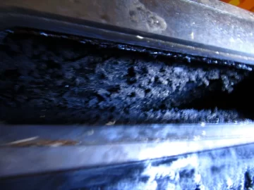

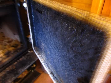

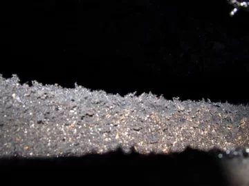

I can't tell you much about the condition of the wood, but she says she burns through 10-11 cords and about a ton of coal per year. Her place is only 24x24 and she usually keeps the bedroom closed unless she's in it so as not to waste heat, and all cooking is done on it as well. (no other heat source). According to what she said, this was a month's build-up, so that's the point we dropped from the 70-90 degree band down to the 50-70 degree band for daytime temps (nighttime about a third above 40, a third above freezing and a third just below freezing). My neighbour brushes out the chimney about once a month (though this brought up a point I observed today, in order to get a brush down into the oval section of the pipe, one would have to get a pellet stove brush additionally and not just use the round brush from the roof)
Anyhow, here we go with scary icky pickies...
that's the cleanout on the far side (where the flueway goes down to go under the oven). Now if the bottom side of the cleanout plate looks like that, I can only imagine what the bottom side of the rest of the top looks like...
quite a bit of fly ash can be seen sitting on top of the oven (under the top), and she can not manage to get the scraper all the way over to the firebox (and the smoke curtain prevents it from going in from the firebox) so we are going to have to get her something more flexible to reach all the way across, if nothing else a dryer vent "bottle type" brush, but that still leaves the problem of not having a decent way to scrape the bottom of the cooktop (perhaps it would have been better if another access door would have been put into the side)
quite a bit of fur (in fact almost a forest) of ash going down the side of the oven. As I said, if those pretend vents on the side do anything, they're making more of a problem by cooling it down more (and too, this is the side facing the exterior door of the place, so that too could add to it)
One last, and here I have no clue what is up, is she burning much too low during too warm of weather, is she really not operating the controls right, or is she not using the top air intake (wash) and instead only using the ash door intake (perhaps even supplemented by that automatic damper widget on the back). Whatever it is, we have to address this, and sorry that the picture is shaken (but not stirred), but glass isn't supposed to be furry. IMG_1634.JPG
She's been burning wood for ages, she's had this stove in use for more than a year, so I really think that at least part of the problem has to be with the stove itself or else she would have been burnt to a crisp 20 years ago, as this is what you'd expect out of someone that's never used a stove before or neglects any sort of "housekeeping" (by the way, after the chimney was swept and she raked out what she could, it amounted to about half or more of a milking pail)

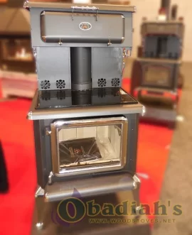

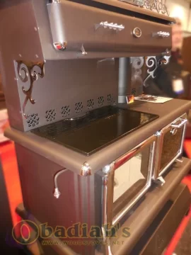

I wanted to make an update on the JA Roby Cuisininer since my last post was not that favorable. JA Roby did address the issue and it has turned out that they are a great company to work with as they actually listened to my concerns and addressed them. The smoke now travels around the oven and heats it much better than it did. Although I still have been too busy to burn one and make a video, I am pleased with what our clients are reporting back to us in terms of satisfaction with their purchase.
This is what the original Cuisinier looked like, notice the smoke stack is right above the firebox, otherwise it looks the same. These stoves don't have the smoke path around part of the oven to help heat it, hence the ovens did not heat evenly. The new improved Cuisinier's don't have that issue. Also there is also a porcelain cooktop that can be added that keeps the stove looking better longer. cuisiniere-june13.jpg
new-ja-roby-cuisiniere-wood-cookstove.jpg JA_Roby_Cusininier_Cookstove_SE_Corner_View_Porcelain_Cooktop_1_1.jpg
