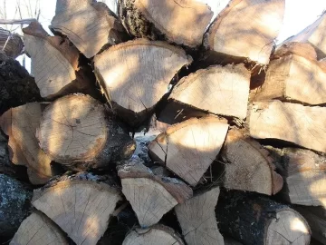

    In winter the relative humidity can be rather high, it's the absolute moisture content that is low. For much of the country (including NY and PA), wood reaches a lower EMC in the spring than in any other season. That is because the RH is lowest then. This is true, in spite of our famous "April Showers".
    Oh... firewood will definitely dry during the winter. This hickory was cut from living trees last December. The photo was taken after it had been stacked outside for about a month. There is some oak in there, too. As you can see, it didn't fare as well as the hickory.
