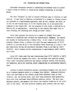

Well, I've been reading this post with some interest & I decided to take the bull by the horns and contact John Gulland at
www.woodheat.org.
He directed me here:
(broken link removed to http://www.woodheat.org/tips/drywood.htm)
Interesting reading...
Yee Haw. Thanks Daksy, that brings it full circle.
" The dryer the wood, the more dense is the smoke at a given heat input rate."
That was the missing piece of the puzzle for me. I didn't realize that smoke density would increase with dryer wood.
And once again, thanks John Gulland.
Edit: and for those that choose not to read it, John also stated that it would be difficult to get firewood down too far without a unique environment such as desert or under barn roof (I would assume that this would take some time as well).

If "dry" equals "kiln dry" then it would fall in line with the other post. If "dry" is in reference to "properly seasoned firewood", then I don't buy it.
Being the gubment, they probably stacked kiln dried 2x4s in the stove for the test.
Right Jags. And I'd bet you a case of the finest beer that even my wood that sits around doing nothing for years still has a moisture content of 15-20%. In other words, regularly cut firewood is not going to be too dry even after 10 years. However, Erik might have a problem with his 40 cords in his barn...but I doubt even that. I would not be afraid to burn it at all. If he lived closer I'd trade him some just to see the difference, if any.
government tests of chimney fires, the dry wood produced slightly more creosote.
^reason #47 why you can't trust them anymore.
Well I'm just gonna have to throw down and call BS on this government report. People that put the governments stamp of responsibility on this should be severely and harshly dealt with.
Of course I'm the heretic here cause I didn't do an official study.
