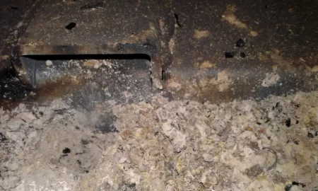

If it looks like this, stuff it shut with a piece from an old ceramic blanket maybe?
May sound like a dumb question but what would be a good source of this stuff for this application? I don’t have any and not sure where to get.
A ball of aluminum foil might be easier to try.

Aluminum foil won't last long but it should tell them if it addresses the issue.
Another thought, but not sure how long some rockwool would last?
I have some extra door gasket so that might be good. At least for this temporary fix.
