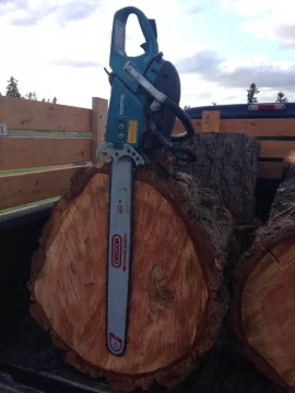

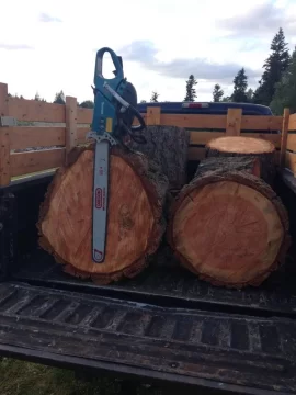

Finally got to get into some doug fir that made my 28" bar feel small. Stock HD rental saw with skip chain. I traded my MS290 for this saw a couple of years ago and really like it for bucking. It's awfully heavy when you have to limb a tree or work in a pile of slash though. I pack along the OEM 20" bar and a few chains for backup.
Saw still has cat muffler and I've never touched the carb screws. I sure do like the huge fuel/oil tanks.

Good looking saw.
Reactions: Highbeam
Nice picture. I'm a big fan of Dolmars / Makitas they are just so well thought out or atleast the ones I've had a chance to use.
Are you going to put the big bore kit on it ? Seems like an easy way to get even more power if you wanted more. Not that the saw needs it they run strong in 64-65 cc form as it is.
By the way those look like some big heavy rounds you got there. How did you get them in your truck ?

The stock dawgs are big but provide clearance when noodling down rounds. Last night I filled the truck with cherry that was 30" or so and I couldn't lift them without cutting in half. Does removing the cat make them louder? I like a relatively quiet machine but also like to let it breathe.
The dolmar has been super easy to start. Too easy. Maybe my home depot already tweaked the carb. I haven't looked to see if the screws are epoxied shut.
Those big fir rounds in the picture were too big for me to lift as well. I started cutting (noodling) the first one and a guy popped up from the house and helped me load. Big rounds are much easier to load with two people. Not awkward and the truck gets filled FAST.

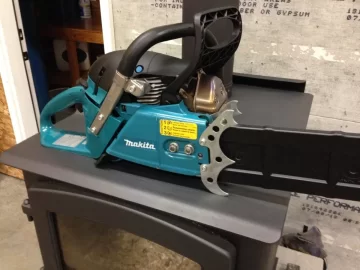

Here's another pic after I first got it. 20" bar is good backup.

That looks like a great saw! I just found two 6421s at HD and I'm going to buy them both. I have a PS510 and it has been a great saw, looking forward to something a little bigger to go with it. Thanks for sharing!
I would love to do the upgrade but isn't there some issue with the OEM 6421 plastics and the compression release button on the 79cc kit?
Not with your saw based on the picture you uploaded. You can get the kit for about $200. Even if there was an issue, the kit comes with new top cover that aligns with the decomp valve.

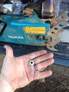

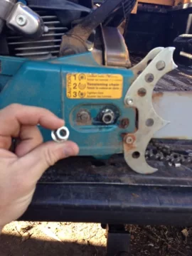

Dolmar guys, beware of this problem. It may be my fault since I've only ever ran Stihl saws and their nuts are bigger (haha). I was noodling the big fir rounds in the photo and the saw spit out the chain. Weird, I thought. It wasn't loose when I started. Then I noticed that the cause of the spittage was that I had loose bar nuts and one was GONE. Hell. I'm a long ways from home and need to load a lot of wood. Since I had cut in this same place yesterday I started looking through the piles of noodles and got majorly lucky. Like lottery lucky and found it.
I did bugger up the drive teeth on the chain so I need to un-mushroom them before I can reuse it but since I found that nut I was back in business with a new chain.
How tight do these little dolmar nuts need to be? I'm just using a scrench.
Oh and I'm not fat, my hands are just very meaty. Looks like I'm the marshmallow man in these pics.

I just crank mine down hand tight with a scrench (I don't crank it as hard as I can, just nice and snug plus a bit more). Never had one shake loose, but I usually undo/redo them to adjust the chain every tank of gas.
Maybe replace that nut in case the threads are worn down, and check the post for the same problem. A little plumbing teflon tape could help temporarily if the threads on the bolt are worn.
