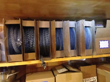

Some stoves I have seen make the joint in the middle of the bottom or side. I like to make the joint in the lower left corner looking at the front of the stove. That is a nice out of the way place and joining in the corner is easier. I also like the Hi Grade Graphite Impregnated Grapho-Glas. I always keep a little on hand. :) See pic below. Click to Enlarge
P.S. The clear Hi Temp RTV not only works well and is easy to use but looks good too!
