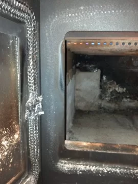

With burning season just ahead, I thought I should get the stove ready. I'm wondering if I need to change the door gasket. Its only been a year but the seam where the gasket ends meet is fraying. From the factory, the seam was wrapped. Judging from the soot patterns on the face of the stove opening, air has been getting in there. I checked the face with a straight edge and the face in that area was warped a little. So I hammered it to make it more flat and tried the dollar bill test. It wouldn't budge. Should I go ahead and change the gasket? I don't think I could do a better job and not have the ends fray like the current one. [Hearth.com] Door Gasket

-Gasket would not be the issue in this case, i glanced at your manual, and it does not mention door fitting. I would carefully examine how the door is hinged and latched, to see if you could CAREFULLY (without hammering) adjust the door.
Post some more pictures of the latch and hinges for ideas.
I would suggest NOT replacing the gasket until you figure out how the door can be adjusted to stove frame.
Nonetheless, the gaslet looks like graphite impregnated material. If you go with Rutland make sure you get the kit with the BLACK cement.

looking at your pic, i do not see an issue worth sweating, your stove face shows a little air has been getting through that "butted end" area, but they all do that to some extent. i say let it rock, just maybe carefully trim a few of the frayed end with a good pair of fabric scissors
Looks more like that air is coming from the airwash than the door gasket.
ya, thats what im seeing, but its seeping a little , see the shiny black streak just above where the butted ends meet?
i still think its a "non starter" i wouldn't worry about such a small leak just yet
that small a leak ain't gonna cause any warpage, my guess is the warp was in it from day one, but the gasket should seal the slight bit here, seriously (to the OP) the small seep you have here did not warp that area

I think the OE gaskets are the high-density type, whereas the Rutlands and stove shop stuff are a looser weave, which doesn't seal as well. If you've got a small piece of left over gasket around, you might try cutting a small piece and gluing it into the gap at the ends of the door gasket with some high-temp silicone. The silicone should also keep the door gasket from unraveling further. Put some paper between the patch and the door frame to make sure any glue that seeps out doesn't stick to the door frame and pull the gasket loose.
