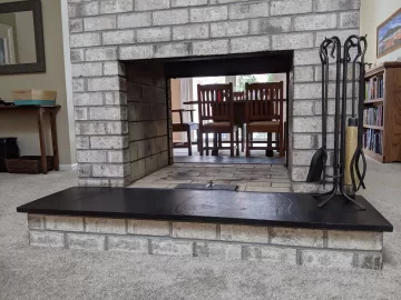

Hello!
I have a double sided fireplace that is useful for evacuating all the air in the house (~1500 sq ft) and making the room smell like smoke :)
I'd like to be able to have a fire that actually makes the house warmer without worrying about sparks flying out onto the carpet. Main heat is provided by a heat pump with electric resistance backup, so the ability to heat the house in the event of a winter power outage would be very nice.
The existing openings are about 36" wide and 27.75" (28"?) tall, and the total depth between the two openings is a little over 36". There is a steel "box" above that funnels smoke to a pivoting/chain operated steel damper. The hearth extends 17" from the brick face.
I understand there isn't such thing as a double-sided wood stove or insert, and that's fine. I'm wondering if it's possible to fit a wood stove inside the existing fireplace, or if I'd have to go with an insert. I think it would have to be fully inside the fireplace because I don't have a large enough hearth to put it outside. I'd prefer a stove because I think it would look better from the other side and you'd still be able to see though the fireplace to some extent. It looks like some of the Jotul stoves have a short leg kit that would make the stove as short at 26" so they might physically fit, but it's not clear to me whether this sort of installation is good for the stove. There's also the slightly more complicated matter of making sure the stove flu outlet lines up with the existing damper.
Thoughts on these options? I've attached a photo, note this is from before we bought the house, the TV and cable race has been removed.
Thank you!

Options are slimmer as we wait for 2020 compliant stoves to return to the market. Based on the dimensions, the Jotul F45 with the Short Leg Kit #157636 would fit. That is their hearth mount option. It would work. The Hampton H300 with the short legs would have fit and met the criteria, but it has not returned to the market yet.
The stove will need a 6" stainless liner and a block-off plate at the damper is recommended.
A freestander's backside does not look nicer than a insert's backside. A rare situation is also a rare opportunity to do something truly original; For example you can have an insert on one side and a fish tank on the other? Some tropical fish need to be heated.
Clever idea, but I think a heat shield would be needed. Without one, that might end up cooking the fish. Another solution is to put some sort of screening on the backside. This could be expanded or perforated metal. It will allow some heat to convect on the backside.
Our Jotul insert works great in our double-sided fireplace. We have glass doors on the non-insert side and open them if we want heat in the dining room (stove faces living room).

I really like my hearth mounted Jøtul. The back side isn’t beautiful and has the UL listing plate that can not be removed but it is not ugly. I do think free standing stove with legs look better than an insert and no surround. Consider a blower as I think it really helps with a hearth mounted stove. Do you want to keep the double sided look?
Bit of a spit ball idea but I will throw it out there is to remove hearth on back side (im guessing this is the sliding door side as it’s not needed bit I’d wait till you redo carpet/floors ) and extend it on the other side mounting a rear vent stove completely outside the fireplace opening. Gives you more of the see through look and hides the back of the stove as it won’t be as easy to see from the back side. Two reasons thoughts one is completely aesthetic. That is a really tall piece of brickwork you have there and stoves look really good in front of tall walls. The other is the room can get more radiant heat from the stove. Just some thoughts.

If possible I'd like to keep some of the double-sided character. I think I could achieve that with an insert w/out surround or a stove, the difference being an insert would have space between the top of the firebox and the lintel whereas a stove would have space between the bottom of the stove and the hearth. I'm thinking with the glass doors removed a stove would look better than an insert without the surround. If an insert would be objectively better in this situation I would use the surround and figure out a way to make the other side look decent, but the jotul f45 for example would have a 6" gap on either side so you could still see through to the other side.

Someone really needs to figure this double sided fireplace insert thing out. Doesn't seem like an overly complicated thing, and this question comes up frequently. A double sided fireplace is a really nice architectural feature, and to turn it into a good heat source would be really great.
In any event, that stove will look cool in your fireplace and be a great heater as long as you make sure to have an insulated block off plate. You just have to decide what side the door goes on, which you probably already have.
One other cool thing about the double sided fireplaces, all that masonry in the middle of the house will soak up the heat and you'll have a nice masonry heater going after the stove goes out.
Insist on a block off plate, and insulated liner. It’s way easier to do before the stove is installed. I just got around to making and installing a block off plate (haven’t insulated it yet). And it make a huge difference getting the heat into the room. Hope you enjoy it as much as I do mine.
