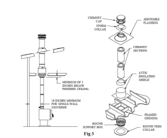

Stovepipe, whether double or single-walled, can not pass thru a wall or ceiling. It must be class A chimney pipe after that. You'll need a ceiling support box that supports the chimney pipe.
