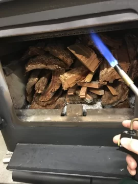

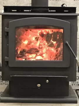

It sure is fun to burn these scraps from processing the 2019/2020 fuel.

Nice. Burn time on full load?
I burn this stove pretty hard to heat an 1800 sf building with a bigger than oem blower plus convection deck.
Burn time is very consistent at about 3 hours for a full load of Doug fir firewood packed to the top. That’s 3.5 cubic feet of fuel per 3 hours. I’ve been able to do 3 back to back loads at that rate. These bark loads burn just as fast but I believe they are lighter so less heat is released.
I aim to hold 700 degree stove top temperatures which is way below the safe limits for a steel stove.
Yes, a wood furnace would be more appropriate but none are clean enough to be legal in Washington. Not even the kuuma.

I did a full load of bark/chips/sawdust/etc last year. It didn't burn as long as a full load of wood, but it burned completely, which I didn't expect (I thought the stuff on the bottom wouldn't burn due to air not being able to get down there).
It needs a lot more air to burn clean and hot in my stove so it really burns in a front to back manner. Like a huge cigar. Not many flames after the first hour or so.
