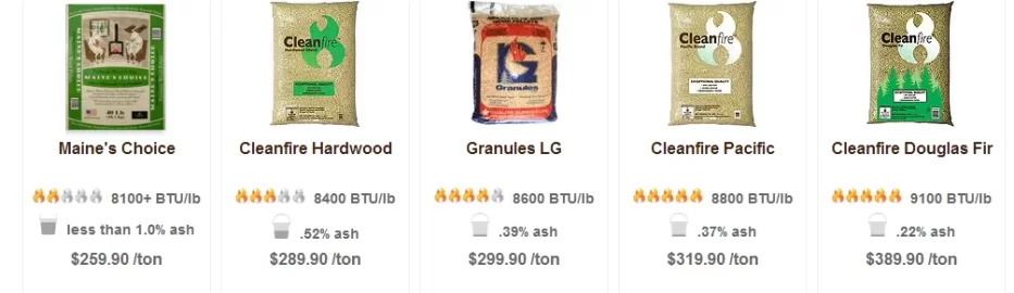

FYI
In New England, Doug Fir is definately not the most economical but a real Softwood pellet, but it is easier on the auger system and stoves like Thelin work better with them.
I am trying them to see if the ash is alot less like they claim.
0.22% ash is very low!

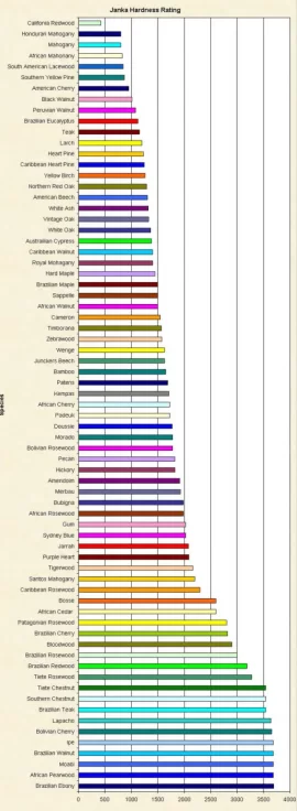

The U.S. Janka hardness rating for Douglas fir is 660. This puts it fairly low on the scale

FYI
In New England, Doug Fir is definately not the most economical being a real Softwood pellet, but it is easier on the auger system and stoves like Thelin work better with them.
