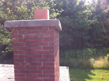

Just shooting in the dark without being able to see the setup and chimney but willing to bet that if the chimney is in that bad of a shape that water is leaking down from the crown into the firebox and mixing with old deposits and causing the smell.
Pull the surround and see what is going on back there. I am willing to bet you will see evidence of water having been on top of the insert if it is a crown leak.
What condition is the chimney crown in? A cracked crown is a very common place for water to infiltrate. How is the mortar?

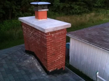

I was having some water making it's way in, I tuck-pointed the areas that needed it, cast a new concrete crown, and then water proofed the entire thing. I have had no more issues.
If the crown is in decent shape, you might get away with a crown coat and a good waterproofing.
Here is what the new crown looks like. The old one was mortar and had no overhang. I also added new counter flashing. The overhang and waterproofing is really the thing that makes the biggest difference.

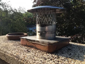

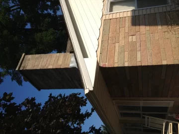

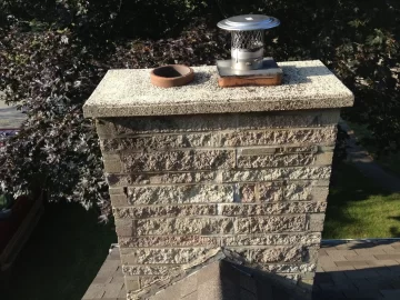

Here's some pics,
  • [Hearth.com] Down draft problem With fireplace, behind insert

Is there a crack between the clay flue and the crown? Might put some concrete crack filler around it. In pic #3 the stone has some blackness, which is caused from water running down the stone, water might be able to run under that overhang on the crown if there is no cut or recess cast into it. The cut on the underside of the lip allows water to drip off when it hits it, otherwise it can return all the way back to the stone and make it's way in through any of those hairline cracks in the the mortar.

BTW: I would not kill but would significantly maim to have a nice chimney crown like that. >>

I don't think a leak from it could get into the fireplace but the base of that chimney is in serious need of a good flashing job.
Excellent pic. Great Job. Did you cut and bend that sheet yourself?

The base flashing around at the roof line looks like it has a lot of caulk on it. Technically, it should be set into a reglet that is cut into the masonry. But if good caulk is used and it is a tight seal, may not be an issue.
The top plate should have been bent down on all four sides so that it dropped over the edges of the old clay tile op. The have it flush on top with caulk around it. I would inspect that real good and look for any gaps, fish mouths etc that may let water run in.
