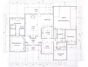

Stove is planned to go on that top wall in the living room.

So you want to place the stove where the fireplace is indicated in your plans? Not a bad location, relatively central. You may get problems with the heat transfer due to the ceiling height as the rest of the house (and especially the corridor) has a lower ceiling. If you have proper clearances there is no real need to have any special walls around the stove but it may look nicer. One example:

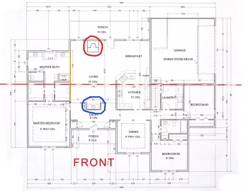

Back to my plans...
Red is where I had planned to put the stove.
Blue is where I wouldn't mind putting it but then the chimney would be on the front side of the house.
Id like to keep the yellow wall completely clear.
Im not saying that Grisu misread my plans. I just didnt think I had it in a too central location. The Blue circle are plans for a built in computer desk.

I think the red circle is a good spot.....not perfectly central, but it is hard to do that sometimes.
I like the blue spot better. It's more central. The chimney could have a chase installed.

I said central in regards to the East-West orientation of the house. Most people want to put the stove on an outside wall, so the red circle would be about as good as it gets. The blue one may be even better but that will be an alcove installation with higher clearances and you will require a blower. It would be a perfect spot for a zero clearance fireplace. Sure you don't want to look into those? They are essentially like woodstoves designed to look like a fireplace. This here would be the PE Summit equivalent: http://pacificenergy.net/products/wood/fireplaces/fp30/
