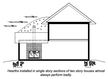

It might be the chimney location in relation to the house? If this is a cold exterior chimney it may be more sensitive. How tall is the Northstar chimney and where is it located? How is it positioned in relation to the prevailing winds?
[Hearth.com] Downdraft Mystery
http://www.woodheat.org/wind-chimney.html
