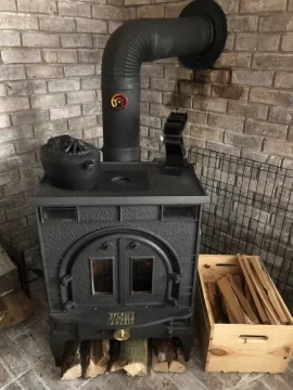

When we bought our home 4 years ago, it came with a 1980's Dutchwest stove. I've been fighting with it every year, with the biggest issue being back-draft. I can feel it come down the chimney when the stove is cold (hard to even light a lighter at times!) and I've tried everything to keep the house from smelling like smoke every time we use it. I cannot, for the life of me, reload wood without smoke spilling back in to the room. For the record, I do know how to use the air vents and bypass. ;-) Our house was built in 1988 and isn't exceptionally tight. I always open a window and turn off our furnace, as well.
In addition, I find that it's very difficult to keep the chimney temp in the "orange" zone after activating the cat. It drops very quickly. You can see in the pic that the temp gauge is right at the borderline of too cold. Here, the cat is running about 1300 degrees and the damper is wide open.

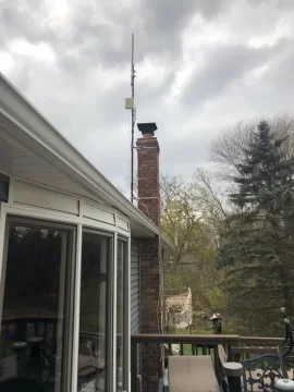

The 6" dumps into a masonry chimney so I'm wondering, if I had the chimney lined with 6" all the way up would that help? Or could there be other issues present? (Btw, the thimble leaking down the brick is a whole other issue that I haven't been able to solve)

Cooler flue temps with an active cat are not untypical. As long as the cat is actively burning the smoke it is ok. An insulated liner should make a difference. The chimney also looks to be on the short side, especially with the two 90º turns in the flue path. Dutchwest recommends that for proper draft and good performance, the chimney should extend at least 16’ (5 m) above the flue collar of the stove.

The chimney is a bit short, without a doubt. I'll have a liner installed and see how it goes. Hopefully they can extend the length out of the top of the chimney? Maybe this will resolve the thimble leaking, as well.

Try opening the air control and bypass for a few minutes to raise the flue temp before opening the stove door. Changing the 90º turn in the stove pipe to a pair of 45s with an offset will help a little, as will switching to double-wall stove pipe. But it looks like there may be only about 12' of flue from the stovetop to chimney cap. And the two 90º turns effectively are reducing draft by about 4' of chimney.
