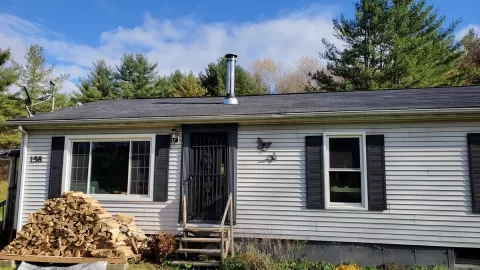

I have just installed a new Drolet Escape 1800 and chimney system in a 1980 something manufactured home. Lit a few break in fires on cold mornings in the 30s. Fire burns fine with the door open but smolders with the door closed even after burning for thirty minutes. I can't close the door until it has almost reached the coaling stage. (Air intake open). When I close the door I get a few minutes of secondary flames then smolder. I know the recently split "seasoned" wood that I bought doesn't help but it's not much better with pallet wood or camp camp fire wood from Walmart. Stove pipe is double wall 5' 6" from stove top to ceiling box. 7" offset with elbows at the stove and ceiling creating a slight angle of about 15 degrees? 7' of chimney pipe from the ceiling box through the attic and roof. Cap is about 3' above ridge which is 7' away from chimney. I was thinking about adding another 2 or 3 ft of chimney pipe to see if that would help. I would appreciate suggestions.
Tony
Wet wood+short chimney=difficult burning. Most stoves want a minimum of 15 feet of chimney. Adding more chimney will definitely help draft. Are the elbows 90s or 45s? Elbows slow down your draft even more
Elbows are 45deg adjustables. As I said they are adjusted to only a slight angle of about 15 deg. The Drolet air intake handle seems to have a rather short travel as compared to my previous PE Alderlea T5. With the Alderlea I could light the paper and close the door moments later and yet still turn it down and burn all night. Too bad that they are now well out of my price range. Boy do I miss that stove! I wonder if 2 ft additional chimney would be enough or if I should go for 3. I will need a support bracket either way. 7 feet of stainless steel chimney sticking up from my ranch roof (6'above ridge) may look a little silly but I'll do what is necessary.
It is a manufactured home; they can be very tight.
Do you have an outside air kit installed?
If not enough air can come in thru leaks, the stove will have a hard time drafting.
No better with window open. I'm thinking add another section of chimney pipe. I wish I knew if 2ft would be enough. It's going to look especially weird since house is on a hill.

minimum chimney height for this stove states 12'. you have 2 slight bends so this probably means you require some height about 12'. the not so seasoned wood isn't helping start the fire.
extending the chimney will improve draft but improved draft doesn't necessarily mean you're going to be able to start the fire with wet wood

Nothing blocking air flow. There is a large opening in the back of the stove for an air intake kit and a smaller hole in line with that in the dust pan. The front air intake is also within the first pan. I did the incense test and the elbows and pipe show no leaks. Picked up a moisture meter and most of the wood is 20 -24 %. I got hold of a small amount of beech that is 16% and also picked up a ton of Green Heat blocks. Definitely burns better with the beech and blocks. North/ South loading is also much better but the 16" splits won't fit that way. It still takes way more time than I like with the door open and lots of dry kindling to get it going but at least I can close the door after about 20 minutes and eventually turn down the air for overnight burn. I'll keep buying/cutting wood for the years ahead and use the blocks and whatever dry stuff I can get this year. Thanks for all of your info and suggestions.
