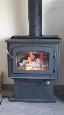

If I missed it sorry, but does your stove leak smoke back into the room when you open the loading door? If so spillage would indicate that your home is a better chimney than your chimney is. Does the wood burn to completion? Or can you leave it alone and the next day there are large coals or chucks of charred wood? My guess is the house may be too tight or the wood to too wet for the burn rate you are using.
As another posted, try some BioBricks. If they burn, then more than likely, your wood is the problem, if not, more likely insufficient draft. If you wind up adding pipe and do not like the appearance, you can build a box around the chimney pipe and cover it with faux stone or something to make it look nicer. Personally, my chimney is pretty tall outside, but I don't care as it allows the stove to perform.
Once you get this licked, you see much improved performance from your investment!
No smoke when I open the door if I open it slowly. Green heat bricks burn well. The wood is definitely part of the problem. I don't like the fact that I have to keep the door open that long to get the fire going. Even using the bricks and dry wood I can't turn it down much until it is almost at the coaling stage. Everything is burned up in the end. I wonder how much difference 2' of chimney would make. 20%, 50% ? I imagine there must be a calculation to estimate how much increase in draft per additional ft of chimney.
Yes, in some cases the additional 2-3' can make a very significant improvement in burning performance, particularly for a flue system that is right on the cusp. If your chimney has easy access, on a calm day you could try removing the cap and inserting a 3' length of cheap 6" warm air duct to test with before committing.
If the additional chimney pipe is added, note that there needs to be a brace on the chimney at 5' above the roof exit point.
Reactions: Split
Today is the first day in a while in the 30s .I started a top down fire with 6 Gren Heat blocks on the bottom n/s and some drier wood. I was able to close the door after 5 min and turn it down half way after 20 min when I could smell the stove paint. 2hrs later it's burning nice and slow. Getting some air in to the fire by using the blocks for a platform or n/s splits and some dry wood makes a world of difference. 🙂

That's good news. Things will continue to get better as the temps stay colder and your experience grows. If you can bring some wood into the house for a week or two, that will accelerate drying.
