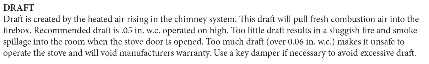

IIRC, BK manuals state the minimum draft requirement in them. I am pretty sure the min requirements have been posted by Chris as well in other threads here :)

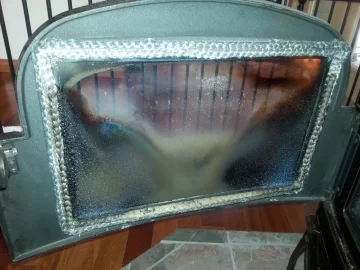

Can you post a pic of your door gasket (a shot of the whole thing)?
Here you go:

The manual does state the recommended draft. What is very confusing it the maximum draft warning. It's just .01 more?? This doesn't seem right. Normal draft variance can be much greater even in an ideal chimney due the outdoor temp changes. For example with the Jotul F55 the reading should be in the .05 - 1.0 w.c. range. Maybe just poor doc wording? Waiting for BKVP to clarify.

The manual does state the recommended draft. What is very confusing it the maximum draft warning. It's just .01 more?? This doesn't seem right. Normal draft variance can be much greater even in an ideal chimney due the outdoor temp changes. For example with the Jotul F55 the reading should be in the .05 - 1.0 w.c. range. Waiting for BKVP to clarify.
A fine line there between recommended and void your warranty!

That has to be a typo, my liner is all of one foot past BK's minimum length, and i regularly see over .10 W.C. on windy days it can average closer to .15. Someone with a really tall flue would probably be .2+
Thanks. In the pic, it looks like the gasket on the hinge side is a little off and I see some dark shading on the outside edge in that area. Is this where your smoke smell is coming from? Is there evidence of a weld in the knife edge in this area?

Yes, that would seem to void out most systems that are running in very low outside temperatures. Hoping it's an error.
It's hard to tell where the smell is coming from. Seems like it's from the top of the stove, near the hole for the cat probe and/or where the stove pipe meets the stove -- but how does one tell with smoke. It could be coming up from the door.
What do you mean by a weld in the knife edge area?

You're going to have to get in close to the door and sniff it out. I'm willing to bet the smell starts at about the area where the gasket looks off between the hinges in your pic.
The ridge around the door opening made of flat plate that sticks out perpendicular from the stove body is the knife edge. It seals like a knife's edge :)
Can you see any welds on this plate all the way around the opening?
