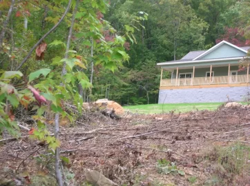

The location could be the problem. Lots of very tall trees all around. If so, 26 feet might not be enough.

Perhaps, but my house is on the side of a mountain totally surrounded by huge trees and draft is fine. However, all situations are different. Breakout the chain saw...

He has tall trees pretty close the the stack, other roof lines close(even though he meets the spec) and a mild climate. Who knows the house could even be in a low pressure area! The bricks are less than ideal, highbeam has even posted about too many of them creating a silly amount of smoke. I wish a member with good seasoned wood in the area would drop by and lend a hand.

My home is on a mountain side surrounded by trees also. VERY similar to yours. I have about 12' total pipe and no smoke spillage or draft problems at all other than a sluggish starting fire in cool weather. Makes no sense but it works.

I just don't buy it, those trees just are not going to make that much of a difference if at all. I have barely 15' of stack in the same mild region, live on a slope, rear vent stove, and I don't have any draft issues. I think you've done an admirable job at providing a vast array of information pertaining to your install as well as making modifications and eliminating a large number of possibilities. Again, I think in general far too many issues get blamed on wood/draft. I had first hand experience with burning issue being blamed on wood/draft. Once I got a better stove in place the wood/draft have proven to be excellent, as I believe is the case for you. Even when I have burned wet wood in ANY stove, it has never shown any greater chance of bringing smoke in the house as long as the door is shut.

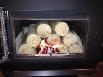

How many of those pressed logs are you putting in at once?
No smoke smell in my room after loading 9 NEILS. The neighborhood got smoked out though for the next 24 hours. Good heat, long burn, too much smoke. Cordwood is nearly smoke free on low so I assume my cat is good.

Mix two pieces of cord wood with each load of manufactured fuel. Due to exceptionally low moisture content, the delayed ignitionyou are experieicing is most likely due to a rich firebox. Lean out the gases with some cord wood and it will help with the back puffing.

Thanks Chris. You're probably right about the pressed logs contributing to the backpuffing. But it seems like the box isn't getting enough air and the smoke smell comes and goes but never goes away entirely. Glad we're finally checking the draft. I hope you had a chance to speak with Dan. What sort of draft readings should we be looking for?

I also would not discount the effect all those trees could be having - prevailing winds & directions of them would play a big part there.
