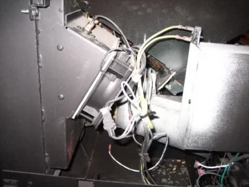

Open the right side. Here is a diagram of the location. According to fig 29, it should be where the red arrow points to.

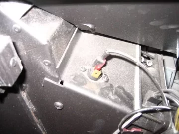

i have the same manual. its not were the arrow is pointing. there is a swithck on the fan housing. the left arrow of the L250 would more acuratley locate it. it has a little red button in between two wires. it doesnt move in any direction. ill try to post a pic
Interesting. That's closer to the location for the ECO 45.
As a test, and only a test, unplug the stove. Then pull off the other spade lug connection on the reset switch. Fashion a jumper to connect the two spade lug connectors that were on the L250 reset switch. You can use a short piece of #14 or #12 wire for this that has its ends stripped. Set the wires so that you are sure that nothing is touching metal. Plug in the stove and try it again.

when i jump them the same thing happens. only when one is unplugged the fans will start up. it seems like it still has something to do with reseting the error. this sucks. ive been running my expensive gas burner all day and i just picked up another ton of pellets.
Are you saying that when one of the switches is unplugged the stove works? Would that be switch F-160? That could be the issue. This is a normally open switch. It closes at about 160 degrees due to overheat. If this is the issue, it's a simple fix and not probably not the reset codes.
Can you post a picture of the switch location for verification?
the 160 switch is located on the control panel box. when unplugging the other switches, the auger still doesnt turn but the fans are all working. the control board is still fully lit except for the lightning bolt icon. does anyone have a phone # for drolet or sbi? oh yea, the 160 is located on the right hand side of the first pic
