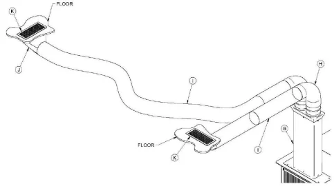

(broken link removed to http://www.drolet.ca/en/products/pellet/eco-65-pellet-stove)
I really like the optional Ducting Kit! There are some heated discussions here about that, but with this nice option there is no jury rigging!
  • [Hearth.com] drolet eco-65...tell me about ? duct systeme yes or no?
