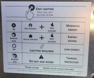

Also, when I click the green “load button,” it blinks 5 times fast.
