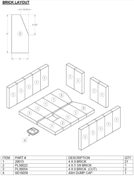

I think I may have found the problem: Nowhere on this stove does it say that this model is a II. The UL sticker on the back merely states the model as "Myriad". The manufacturing date is Jan. 2013. Perhaps this is the predecessor to the II? Was there a Myriad I? If so, I did not have any luck finding an exploded diagram of it.
Then that would make perfect sense, because I believe one of the differences was that the I vs the II was that it didn't have the top layer of bricks.

Here is the brick layout for the Myriad I.

Thanks begreen, yes, they are all present and accounted for.
