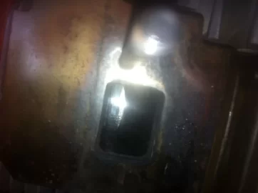

Well pulled the muffler off. You can tell the piston and rings are worn on one side not the other. The model is a MS180C. I further talked to my FIL and he said ever since owning this saw he has had trouble with starting it. He actually had them replace two ropes already in the past. I know he is rough on stuff, but not that rough. I called my buddy who knows way more than I. He said he had to replace rings cyclinder and piston on the same model after 2 years of use.

Also, looking thru the muffler port, you can only see a little bit of the piston & rings - so not sure what you mean by one side vs. the other. Pics are always nice to look at. Compression test should help tell the tale on the top end.
Well anything that's used for limb trimming and bought new 2 years ago is new to me. It has less than 5 hours on it.
To the left of the flash point.

Hmm, that's odd looking. Can't see the best but looks like scratches in one spot? Looks like the cylinder has to come off, but I would still likely check the comp first just to see what it is. Definitely not something that should happen with 5 hours of normal use.
There's no reason for a compression test with visible scoring on the piston. Either he was running the saw with the wrong mix, or there is an air leak somewhere.
Ouch! Those gouges in piston and ring will cause some serious hard starting. Agree that next step is pulling engine out and disassemble. You need at least a piston and ring, maybe jug, too. AL transfer can be removed form jug walls and work fine if no deep gouges. And if air leak, gotta find that or it will happen again.
I would have expected an air leak or wrong mix would have caused more widespread scoring or scuffing. That looks confined to one spot, like from a rough port edge or something.
The suspense builds as we wait for naked piston & cylinder pics. ;)

I like to start easy and go from there. Maybe I wanted to try and start it before tearing the sob apart? Yes I know the cylinder is scarred etc. I've seen worse. It's moving free. Starting it eliminates a lot of questions.Check for spark. I did this just now, it has spark.

You know piston and ring are scored but don't know if the cylinder is scored (can only see small area of the high intake wall). If you think it's worth re-building, an AM piston kit is $6 and an AM whole engine is $30 on feebay. Dealer parts/labor charge would be more than saw is worth.
