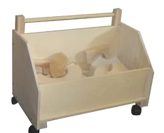

This picture gave me some good ideas as I was struggling to think how to incorporate walls onto a pallet. I'm hoping to build this thing from scraps or scavenged materials. I wish I could think of some kind of sturdy wall that would allow maximum air circulation (fencing?). I'd have to buy fencing though. Seen anything like what I am describing? Any advice? I already have heavy-duty casters for the wheels.

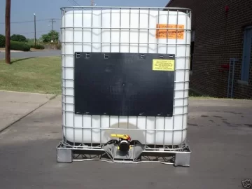

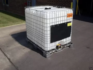

I have a friend that uses the plastic tank holders and are made of steel. Its a pallet made of steel and has the screen cage. He uses 3 and put an axle on them and a ball hitch so he can pull them out to the wood pile , fill them up and bring them back in. His are a little larger then the pictures being shown. You could build one out of cattle fence and a bottom frame.

Sweet. A pair of bolt cutters and I would be in business. What are those tanks? Where would I look for some place that uses them?
The FIRST place is would look is EBAY . There are a lot of different things these tanks are used for. When my friend got his 3 he took the tanks and made water tanks out of them to put behind his house to collect water out of his gutters and then uses the water to water his garden when the rains dont come down as planed. If you were closer i could build you all you needed. If you know a welder you could go to the farm store and got a lot of cattle fence and get some bottom support frame.

Dont forget CHEAP ! I know the farm stores have the fence but i dont know about CHEAP . You might get lucky if you hit your local steel yard and also you can try your local metal scrap yard. Some times you can pick up stuff like that at the scrap yard for .15 cents a lbs. The steel yard will have expanded steel but your are looking at $0.75 - $1.09 a lb .
