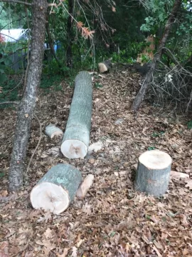

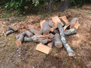

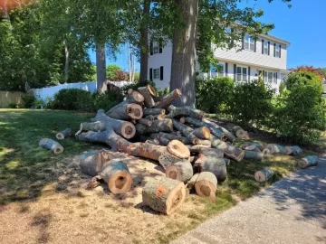

Pics. Amount estimate?
[Hearth.com] Drying oak rounds (12"-20" diameter) [Hearth.com] Drying oak rounds (12"-20" diameter) [Hearth.com] Drying oak rounds (12"-20" diameter)
1/4 to 1/3 of a real cord (128 CF)
CSS (cut split stack) is your friend...and then top cover it...top only, leave the sides mostly open for air flow...it will last a very long time that way.
That is a good looking score. Got some bad rot on a few pieces, but most are very good. I love oak.
In theory the moisture comes out of the ends, but in fact split pieces dry faster.
Reactions: rwh63
About 1/4 cord when split and stacked.

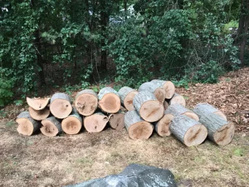

In July we had a big oak taken down at my mother in laws. The base was about 36" in diameter. After it was cut and split , we probably got over 3 chords. Hard to say because it was divided amount 3 people so it was never all in one place at one time. Attached is just the wood from the limbs.
