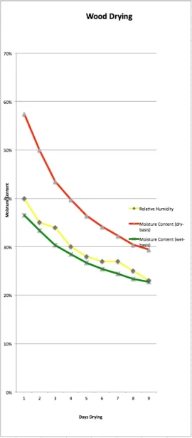

SolarAndWood said:
You took a year off in a week and it was a week in January. That curve has to get pretty flat pretty quick doesn't it?
Not if I change the scale of the chart. %-P

Wood Duck said:
Maybe it is too late to ask this question, but how sure are you that the oven dried piece of wood you used to determine initial moisture content and dry weight of wood was fully dried? Is one night in a 215 degree (F) oven enough to fully dry the wood? The water lost from that piece of wood is the most critical piece of data in this whole experiment, because it is the basis for your calculation of dry weight of wood in the splits. I suggest that next time you bake that wood another night or two and keep recording the weight to be sure it is stable, i.e. the wood is completely dry.
Good points.
What I did was to dry it out in the microwave until the weight at the end of each cycle changed very little. Then into the oven it went, and it didn't lose all that much more by the following morning. Then I stuck the MM into a few pieces and got no reading at all... less than 6% at any rate. SOP for small samples like this (I chopped them up into pieces about 3/4" x 1 1/2") is overnight at 215ºF, checked until the weight stops changing. At most, I might be a few percent off.
Even if I screwed up, the documentation of the changing weight is good information for the membership here. "Skyline" did this in his experiment using fans at much higher RH, and that's really what got the ball rolling in my head.
I'm not at all averse to doing this again, it wasn't really hard or time consuming to do. Takes infinitely more time to post the results and answer questions here. I have at least one more load of black birch coming from the same source (I'm gonna get all he'll sell me at $140/cord ;-) ). I can also ask him to throw some other species in with a load (he has hard maple, red oak, white oak, beech and cherry as well) to try to establish drying curves for them as well.
Let's wait for the data to all come in and then we can look at different ways to analyze it at that point. There are differential equations that describe wood drying rates fairly well. Maybe we can use them to compare the rates obtained from the experiment. And, as a free thinking and obviously intelligent and analytical member here, your input is always very welcome. :)
littlesmokey said:
An observation from a non-technical guy, but your drying will not be linear. It will be a dramatic slope to a very shallow run. As they out parts dry, the inner parts must move the moisture to the air through the already dryer wood. Also, the closer the wood comes to the ambient moisture levels, it will slow also.
Looks like an exponential decay pattern. (which was my hunch from the beginning)

Since BK asked me to challenge his work, I'll see if I can light two fires with one match, and provide my own summary of BK's work, for debate, discussion, etc.
I'll present a quick summary, followed by an explanation.
Summary:
Indoor drying has the potential to dry green wood to the 20% dry-basis moisture content (which is what standard moisture meters read, and what most consider the threshold for convenient clean burning) in approximately 6 weeks, at the expense of about 5% less net energy out of the wood than if it were dried outdoors.
Detail
First I'll present my analysis of drying time, then net energy loss.
Drying Time
I'm simply eyeballing the red, dry-basis line on the drying chart, and guesstimating where it will cross the 20% line. Given BK's analytical chops, I'm sure he can fit a curve to that data and tell us at what point it crosses the 20% level in nothing flat. BK? We can also wait and see when it gets to that point.

(Curious) George said:
Indoor drying has the potential to dry green wood to the 20% (dry-basis) moisture content (that most consider the threshold for convenient clean burning) in approximately 6 weeks
Um, six weeks? He's at something like 22 percent in one week, unless I'm reading him cross-eyed, no? If that's the case, seems to me there's no super-compelling need to wait another month to lose that last 2 percent. If we're only talking a week to get green wood down that far, it's a much more practical enterprise for those of us with first-floor stoves to bring in a week's worth at a time.
I've lost track of how large these splits are, if I ever knew. BK says "medium," but that's like "medium potato" in a cookbook to me, depends on your context.
How much faster would this be if your splits were, say, 2 or 3 inches, and/or shorter? And does it make any difference what the moisture content is to begin with?
I have a couple days' stack of really small (1 and 2-inch, 14-inches-long) splits of not green but mostly not really ready for primetime beech sitting just outside the safe range of my stove, and I've been trying to figure out whether it's much drier after just three or four days or it's my imagination or I've lost track of where I put the dry stuff I do have. (Yes, I have a moisture meter somewhere, but haven't been able to put my hands on it. But by this time, I can recognize roughly how dry the wood is without it.)
The red line on the chart is for the dry-basis moisture content, which is what moisture meters read, and currently stands at about 29%. The line is also curving convex (dropping less rapidly with time). So six weeks is my best guess, eyeballing the red line. Remember, this is starting with very wet wood, so six weeks is nothing to sneeze at.
I'm sure BK could fit a curve to it and estimate the 20% point in a snap.
Oh, HECK. That went right past me.
