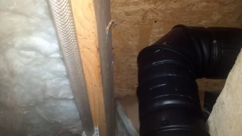

Here is a pic of my dilemma. There is only two inches from the back of the elbow to the floor joist. I could header it off (box it out) but changing the existing floor framing is more than I'd like to do. Is there a type of heat shield I could use? [Hearth.com] Duravent
Was this pipe recently purchased? Can you return it and find the 2" clearance stuff? Be a heck of a lot easier, I think. Tuff to tell what you're doing from that pic, but you could wrap it in Roxul. Don't know how that would go over with the code police though.

True, I could use Roxul aka (rotten cotton) at least that's what we used to call it. I'm sure that would do it.

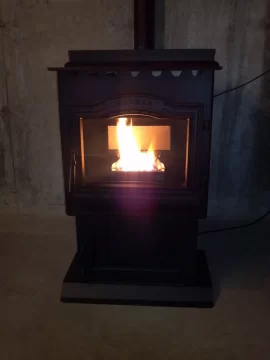

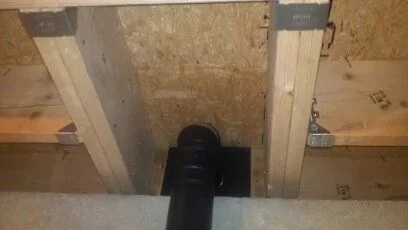

When I ask for advice I pay attention to the answers. :cool: I boxed out the joists in question giving me plenty of clearance and since I plan on finishing the basement wall behind the stove I now have the ability to move it as far off the finished wall as needed.
