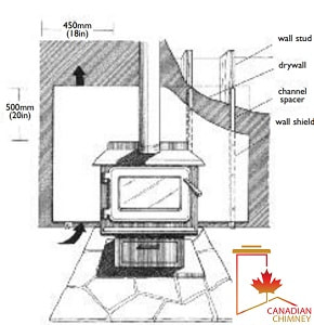

The question really is whether any wall shield at all is required by your install manual. If you are outside of the minimum clearance to combustibles then you can use bare plywood if you want. Anything else is just aesthetic.
If your stove manual specifically requires a particular insulative value for a specific wall shield then start with that requirement.
Typically walls get 1/2" durock when attaching to studs. This due to stability between the studs so you don't have a wavy wall.

The above link is for Canada, what I understand is US regulations are a bit more relaxed than Canadian standards but not sure so verify/check for clearances.
