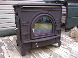

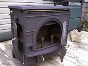

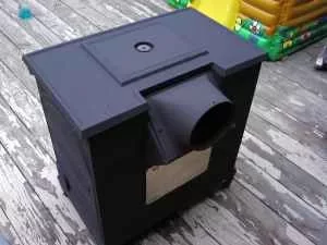

I have an opportunity to upgrade my old Vermont Casting Vigilant stove with a Dutch West stove. I have a few questions before I take the next step (which would be driving two hours to take a look at it).
1) Which model is the stove?
The owner is saying it is the Large 0002461 model, but some of the design elements seem different. Is it because it is an older version or is the owner mistaken? (And I believe the owner isn't trying to deceive me, she just doesn't have deep knowledge on stoves)
2)How old is the stove?
3)If the model listed is the correct model (or if it isn't) what is the burn time and heating square footage of the stove?
4) how much of an upgrade would this be over a Vigilant?
If anyone has any links that would offer additional info on the stove I would appreciate it. Thanks!

thats a catalytic dutchwest stove.. hard to get proportions, but it looks like a larger model.
controlling it will take a lot of getting used to for you, and i would suspect that would be the reason the current owner is selling it.
there are several dial for primary air, secondary air, catalyt, etc. when you have them dialed up right, these work great on a long burn, but it is hard to perfect, and will change based on what wood from your pile you are throwing in there.
We get alot of these in trade for newer stoves, and they are a rats nest to rebuild and work on... often we sell them "as is"
you will probably get a more efficient timed burn on this when it is dialed in correctly, but it will not make your chimney any cleaner.
this will probably do what your vigilant heats now, same burn time, sq ft, etc.

As fire walker said Its a Ex large stove. I upgraded form a vigilant to the DW Extra large . I loved it ,and you will burn less wood with more heat. It a good up grade . I heated my 3000 + sq foot house for 14 years running at 3/4 capacity (I have no furnace) . I never had a problem running my stove. We just filled it with wood and adjusted the air. cleaned it once a year . John
I was a VC/ Dutchwest dealer for almost 20 years. I dropped the line 5 years ago. There were 3 models of the "Federal Airtight", small, large and extra large. The model number listed is for the large. The easiest way to tell is the small and large models have a 6" round flue, the extra large has a 8" oval. I agree 100% with everything Summit said.
