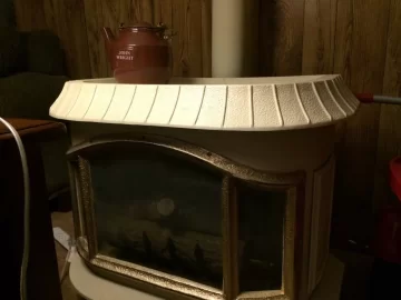

Have an Earth Stove model ES-2CV, input BTU/HR burner 26,500 natural gas. In beige. It was in a home that I purchased and really don't know how much to sell it for. I am eager to find it another home.

Well, its bvent I think, looks pretty. If it works fine I'd ask $450 and take $300-350. Now is the time to sell. I am assuming you wont be replacing it with a b vent stove, so make sure your ad mentions that it includes the pipe.

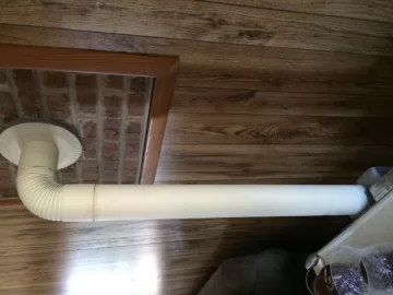

Thank you so much for your help. I originally thought it was b vent, but it is a direct. There is a chimney on the house that it vents up and out to. We are wanting to sell it to eventually replace with something more modern.
I could swear that is a 4" bvent coming up from behind that stove. How are you sure its direct vent? Or maybe I'm missing something and Dak will straighten me out

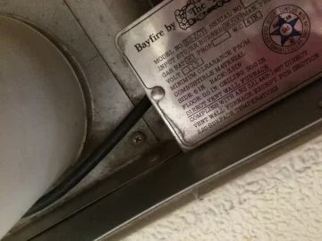

Well...maybe I am confused. This is what it looks like. And the label on the back side.

It says it conforms to a direct vent code, but man, that doesn't look like a direct vent pipe system to me. It looks like what we used to do with old b vent flues, cover them in black stove pipe and paint to match stove. Whats coming out of the top of your chimney?

Regardless of what the rating plate indicates, that IS a B-Vent unit.
The ANS Z21.44B -1987 Standard is for gas-fired gravity (aka B-Vent) and fan type direct vent wall furnaces.
