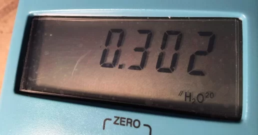

Tks gang, ok I got myself a GE Druck705 Digital Pressure Indicator. I do not have the instructions but there is a "+" and a "-" input on it. I left the + input free and connecte the - input to the stove, I am reading about 0.308 "H2O
  • [Hearth.com] ECO-65 heavy smoke in hopper
This is with the stove running about 1 hour or so? Looks not too bad. Now try it with the window open in the room. I run anywhere between .3-.4
Now close the OAK in the stove for a few min and re measure. OPen it back up and go to the window and put the hose from the meter outside with the window slid shut as much as possible, keep your hose connections the same way. If you can tape up the window gap it would be mroe accurate. If your pressure is much higher then your stove reading then the smoke/flame would be going backward up the hopper.
