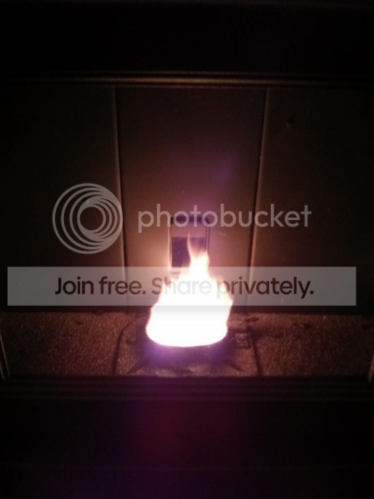

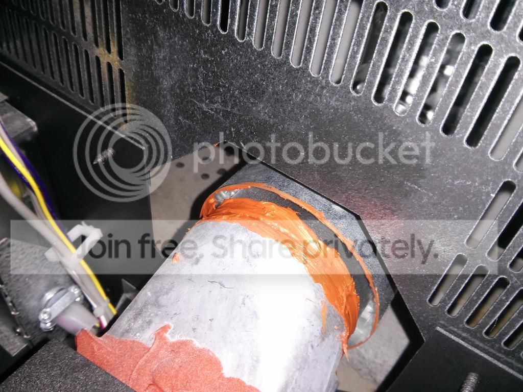

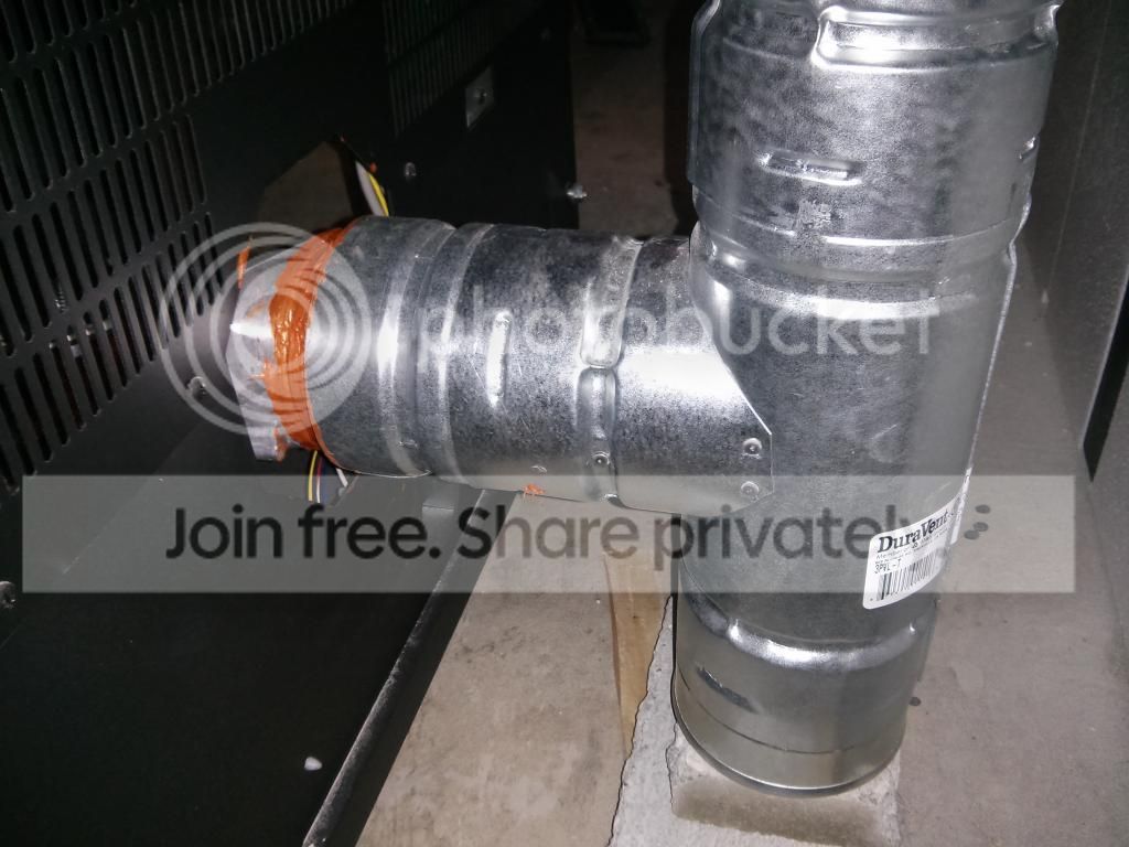

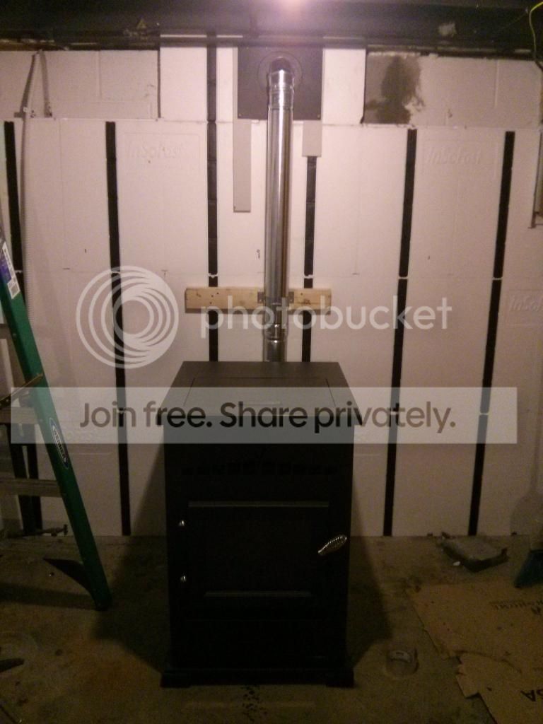

So i got the stove and its been running for about 12 hours now on medium, it used 3/4 of a bag last night the fuel rod is open all the way. Is that normal usage? i have some pics.

Yes, that's abput right for my cab 50 also..different pellets will be different though...I am entering my first winter with out coal and pellets inplace...so far I love it...easy to work on when off warranty...great connection to the quadrafire line of stoves and parts....we'll see....a lot better than shoveling coal and stoaring coal...here comes winter...Robert in Peacham Vermont....
I get about a bag a day for mine on medium with orford hardwoods
I have been messing around with the feed and have it slightly up from closed on low and i get around 3 to 6 inch flame. i did clean the pot and found 2 clinkers about 2 inches long, must be the pellets are not the best? only ran 20 hours

DuraVent 3", I think its running non stop. I have it set to 75::F in the cold room. I did notice smoke on start up between the connections but it goes away after it fires up, are you suppose to silicone all the fittings?
Did you use the appliance adapter? The appliance adapter did not seem to fit very good at all, When I put the tee on without the adapter it fit better.
I got up around 6 and the house upstairs was 69::F in the living room, back bedrooms around 65::F, and the basement was 74::F. I have the stove set to medium with the fuel rod all the way down. It was 22::F when i got up. this thing heats the hole house 1900 sq foot and i don't even have the vents between floors installed yet.
Thanks for the pictures. That looks like what I seen, the rope that help seals is not touching or sealing anything. You just have to seal it up with hi temp sealant. your suppose to use the adapter, but my tee with clean out fits better.
Sounds like your stove is working good and your enjoying it. How well is your house insulated and is it a some what open layout? I hope when I get mine in it will heat the whole house.
