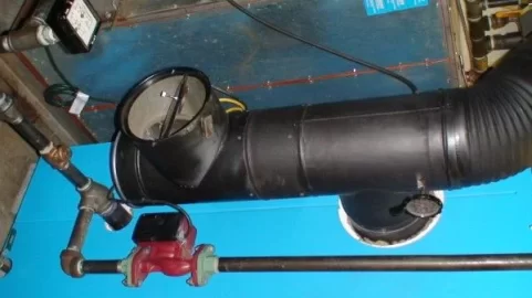

Hi Joe
I have a Econoburn 100 hooked up with a barometric damper and a very sensitive professional quality draft gauge always monitoring draft conditions . Keeping a on eye the gauge is a good learning experience . Once the boiler gets into full gasification mode it will swing the door fully open on the damper and still maintain a .05 wc. draft and my chimney is only a total length of 14' using 8'' triple wall pipe . Like Nofssil has noted , if you run the Econoburn boiler with dry wood an full heat load , the inside of your chimney will have a non burnable fine dust coating . Once you get the hang of it I think you will be sleeping allot better than somebody listening to a oil fired boiler running all night .
Anthony

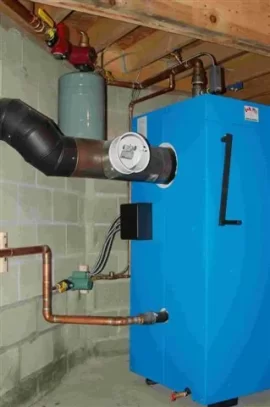

I just fired up my Econoburn 100 for the first time last week. I'll echo the good reviews of Hank's service. After my contractor and I fired it up for the first time we measured the draft and found it was solid at .04. I do not have a damper. See photo. Total chimney height is 12 feet above the flue via 4' excel ultra black (two wall) and 8' of insulated (silver). With that draft you have to be careful opening the door to load it as you'll get quite a bit of smoke if you open it more than about halfway. It sure was fun to see it cooking along after all that work to install!

I suggest installing the damper. In the rare event that you need warranty service of some sort, it may make a difference. The damper's purpose is two fold: 1) prevent the gasses from escaping the heat exchanger too quickly during gasification, and 2) to prevent a hot chimney from continuing to draw air through the boiler after the high limit has been reached... preventing overheating. It is questionable whether or not a barometric damper is necessary for outdoor installations that have only a stack of a few feet or so.

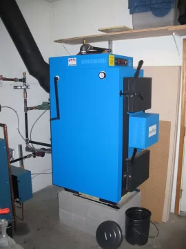

make sure you have an ash cleanout. These gassers will throw a bit of very fine ash up the stack... which can accumulate in an elbow or "T" if the stack is very tall. Had a guy's plug up once becuase he did not install a cleanout on the stack, and gasification ended until he cleaned it out.

Those are good tips. I have to admit I'm new to the boilers and have limited experience with wood stoves. I have not seen a damper on a wood stove before. Are the boilers that different? Will I see that much accumulation of ash in the chimney if it is cleaned annually?
Gary
gasifiers are pretty different. Put the damper in as instructed and you will be fine. I recommend making sure you have an easily accessible ash cleanout that you can get to. Depending on the wood you use, your ash level will vary. You won't need to have your chimney "cleaned" more than once per year... but depending on how your chimney is set up... you may need to remove the ash more than once.
cheers
congratulations on getting yours up and running-
one thing to factor in is that draft can vary tremendously depending on varying conditions such as weather and wind
your 0.04 is a measurement under one set of conditions
one of the roles of the barometric damper is to keep the draft similar under varying conditions
I don't think there's much hazard to not including the damper- but I think the boiler will more consistently be able to extract more heat from the fire when the damper is keeping the draft at optimum under all conditions
that said, the damper (at least mine on my oil burner) lets some amount of household air up the chimney under nearly all conditions, even long after a firing. cold air from outdoors has to come in somewhere to replace that-- so that's probably some net seasonal overall system loss from the B.D. with some chimneys/locations, the damper may stay shut when there's not a fire (my oil system's damper is set up properly with a very sensitive gauge)
more experienced minds than mine will have to advise on whether the net gain in heat extraction from a B.D. outweighs losing some heated air up the chimney in the overall scheme of things
