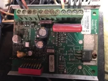

ok so Dale emailed me the factory settings for the controller lmfao turns out the guy had the low limit set to 150 thats why an alarm was triggering. however the problem now is the fan wont run and alarm 1 light lights up and the fan wont run but no actual alarm? Dale wants to sell me a new controller for $600. I'm sure it will solve all my problems however i don't believe the actual controller is bad? i'm leaning more twards the nimbus board. It looks like complete chit from sitting in a garage for 5 years.

i found a new nimbus board on ebay for $55 and a refurbished tc33 controller for $80 i hate to sound cheap but we're on a tight budget and this seems like the better route than purchasing a complete new control unit off of Dale for $600. any advice or input would be appreciated.
