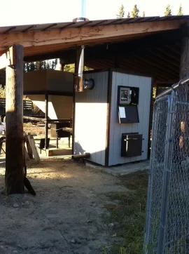

    I un-installed the smoker this summer and never looked back. After burning upto and over 70 cord per winter and doin it for 7 years I had my fill of that life. I turned to technology and love where I am headed.

    I installed a Titan II Coal boiler in the place of the OWB this summer. Much cheaper fule than wood and its easier work. I am currently heating all 4 buildings with it.

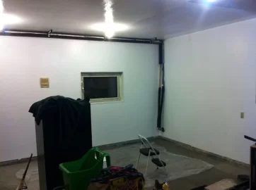

    I spent about tonight preping for paint. I decided to take a slow approach and make it pretty. I am painting the garge walls, epoxy'ing the floor etc. Want people to like wajht they see.

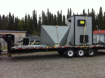

    Home with unit
    Unloading

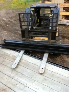

    Assembly time
    Thank god she let me get the skidsteer a couple years ago
    Gotta love a good woman

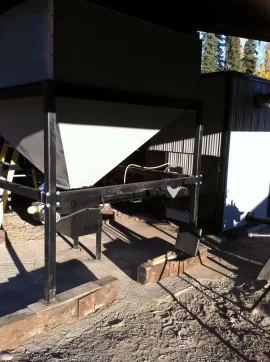

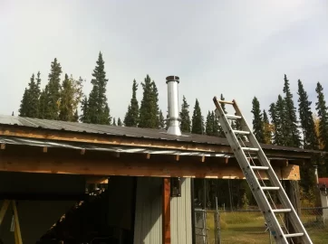

    Set in place, stack just finished

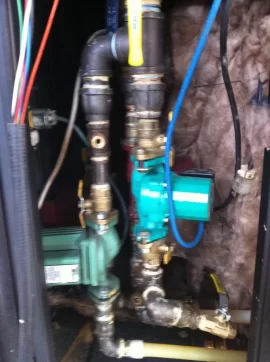

    Plumbing time

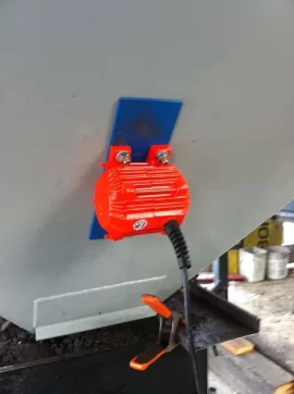

    VIBCO
    Vibrator, helps with bridging in hopper

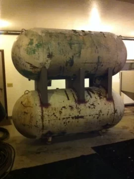

    Well it was a busy night after work tonight. Got tanks inside, and was able to stack them with my skidsteer. No room to spare, the top tank scrapped the cieling very lightly as it went over to sit down in the saddle that is welded to the lower tank.
    Painting things bright white

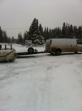

    Truck has arrived, wasted no time unloading

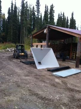

    Strategic location waiting to clear space in garage

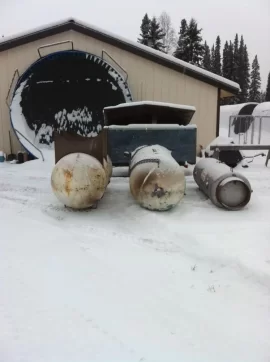

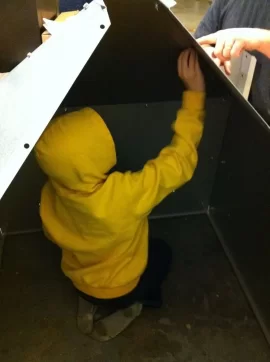

    Started bringing tanks in one night about 10pm and 30 below zero. My calibrated eye ball said "go ahead and stack it up, there's room" Well the tank craddle in the forks of skid steer just barely grazed the cieling as it made it over the high point of the craddle and sat right down. Glad she wasnt awake for that one.
    Kids are taking an active approach adn enjoying this event

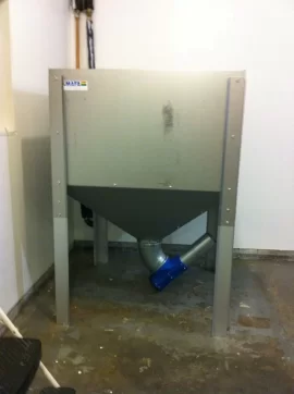

    Pellet hopper together and looking good for those lazy nights

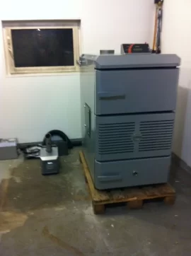

    Waiting for buddy to get here so we can slide it off pallet.
    Pellet gun sitting beside boiler.
    very impressive construction. I am hapy so far.
